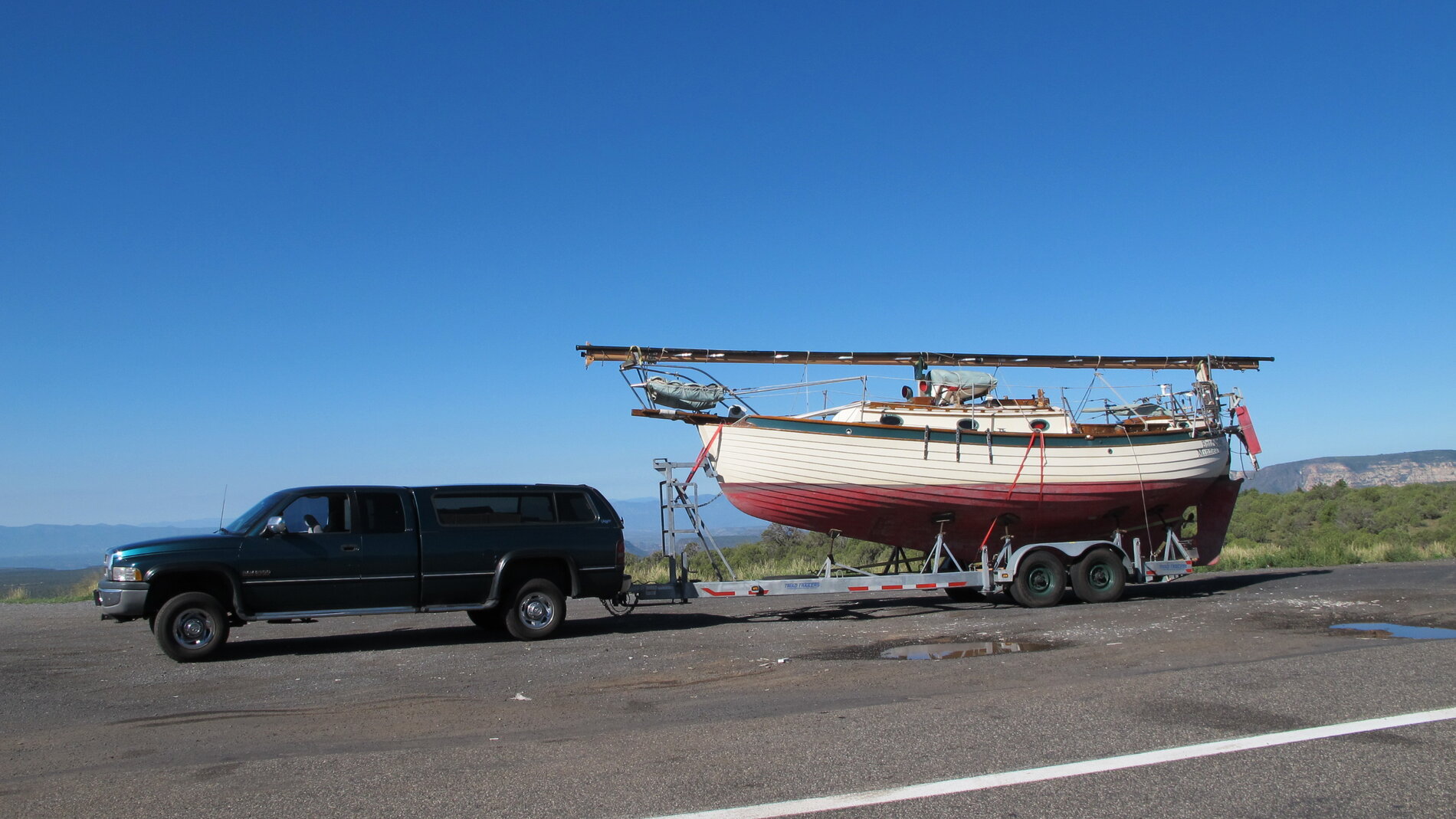

This is my 97 Ram and sailboat 13,400 as pictured approx 950 lb TW ---Looks like it could use a bit more EQ Spring Tension.
Will try for 1100 on new trailer next week.
