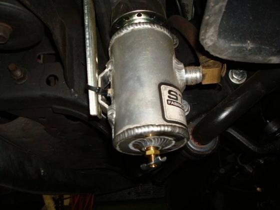

Put this on a few years ago--I got tired of all the mess-emptys quick and easy- capcomes off at every oil change for cleaning--
240556 miles --Summit Racing--and no the wire tye is not holding the canister on I just forgot to take it off after bolting canister to bracket

Mark, I have never seen one of those, looks like a good product. I, like a lot of other guys just extended my hose, but I have to wipe up the drip when it hits my shop floor, looks embarassing when I have somebody up and there are oil drips dotted everywhere
Volsfan I looked in the new summit catalog-and didn't find it but the product is made by STEF'S Fabrication Specialtys Lakewood Nj 732/367-8700 aprox 7"long 3" dia -very well built--No longer have any drips etc to clean up--I made the brackets
