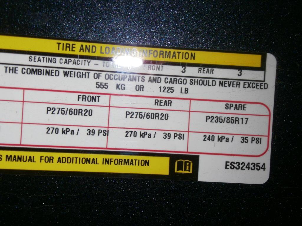

The payload on my quad cab long bed 4x4 Ecodiesel is 1225 pounds. I doubt your Lance is actually 1750. It might be dry but loaded it has to be over 2k. So at best you are 500 pounds over and that is before you add two people and gear to the truck (remember the 1225 includes people and gear). My guess is you are going to be near 1k over the rating of the truck. If you ever get into an accident you will be in a world of trouble. Also remember anything you add to improve the ability to carry weight does nothing to increase the legal weight limit of the truck. These are light duty trucks. Just because they have lots of power does not mean they will do what a 2500-3500 can do safely.
