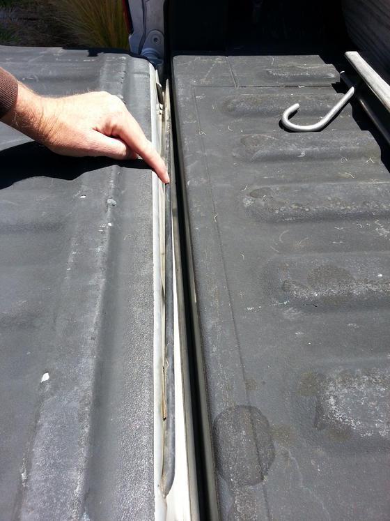

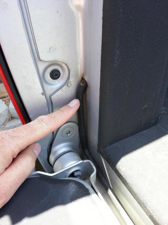

I have a 2005 Ram 2500 QC Bighorn Edition and I want to remove the tailgate. The tailgate has what looks like a factory installed assist spring that is preventing me from fully removing the tailgate.
Does anyone know how to get the tailgate past this darn thing or do I need to get rid of it? If I need to get rid of it any suggestions on how to do it without scratching the crap out of the paint?
Here's a couple of picts.

That is an aftermarket torsion spring. Works just like the older dodge deck lids. I have not played wit one but a friend added one to his truck. Said it was a snap to install
Possibly while lifting t gate off of quick release hinge you will be able to slide the gate off and the spring will unload
Take the tailgate off as normal. have a friend help hold near vertical. slide the rod out of the tailgate. there is a couple little wrinkles at the end of the rod you have to tilt the tailgate to get the rod out. . after that is off, then remove the rest of the rod from the side. . lift up and slide out. .
