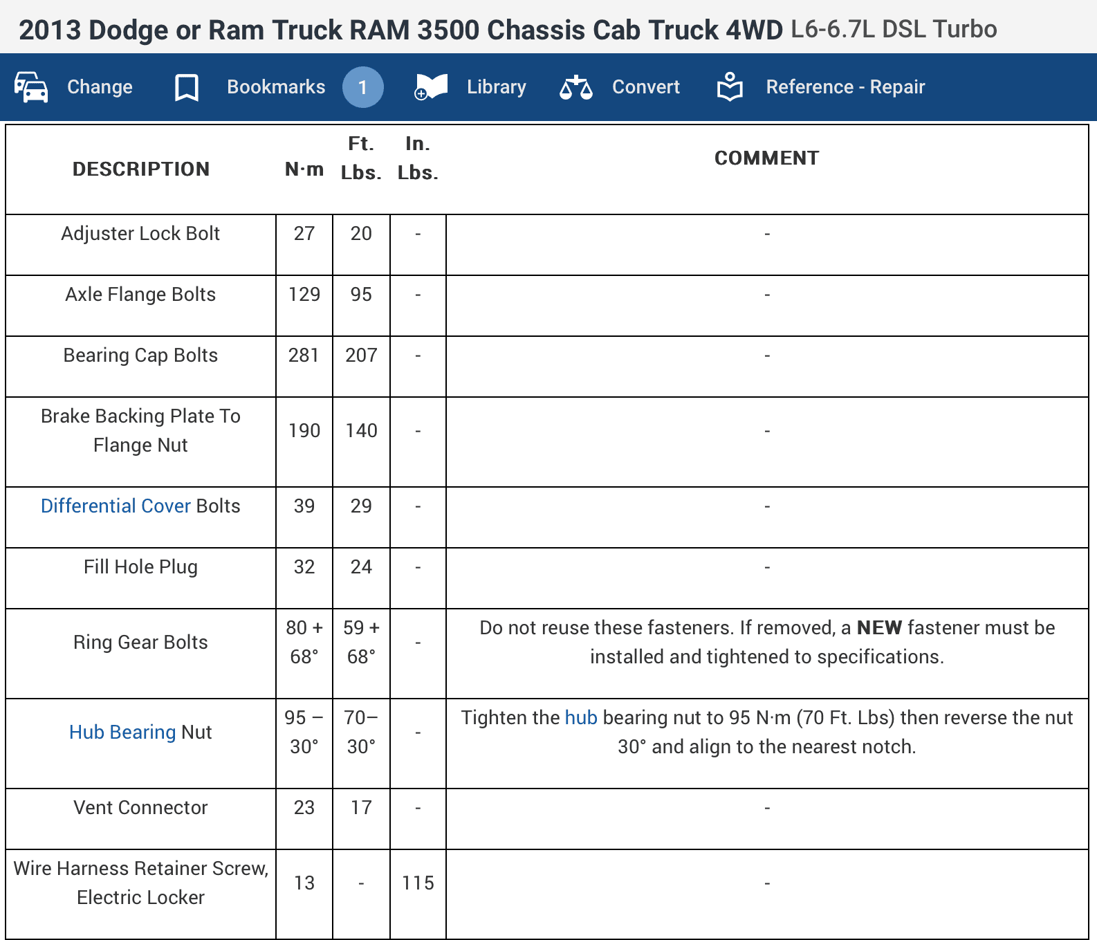

the thread is about the 13 SRW 4 door 3500 4x4 like the title says, I torqued the carrier bearing caps at 85, hopefully that is close as I did measure them around 70 before dismantling.

According to AllData, bearing cap torque on the 11.5” AAM is 207 ft/lb. You better retorque them.

I think your a little over at 85, but probably fine. What I see is 63ft lbs.
Thanks everyone! Re torqued bearing caps to 63ft pounds! Super awesome Carli Ball joints are in, new seals are in! Only need to press new joints in axle shafts and she will be back putting in work!
