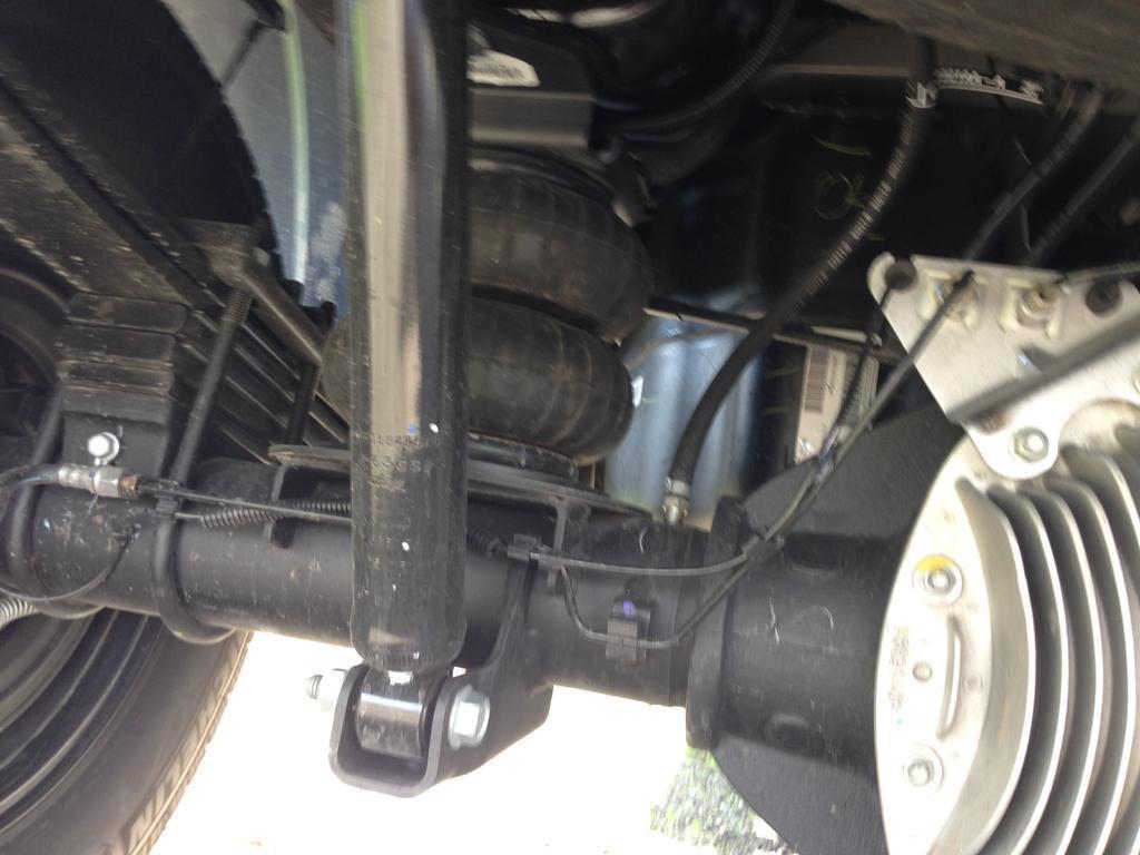

What advantage does this OEM air system have over an aftermarket system . Lot more money for the OEM ,and a system that you really don't have much control over.
If you want a QUALITY aftermarket system it will cost you some serious $$$. I had one on my 11 HO Dually. If I had paid to have it installed I would have spent the $1,355 the factory system costs easily. No a simple air chuck at the license plate does not compare in any way.
Advantages? There is a much longer warranty, there is regular ride and alt ride height, both are lower stance running solo than the regular sprung trucks. In Alt ride the truck sits the same with or without a load. The ride is improved solo and loaded.
Alt ride solo in first pic. Max rear axle load of 9,750# on rear tires second pic.
