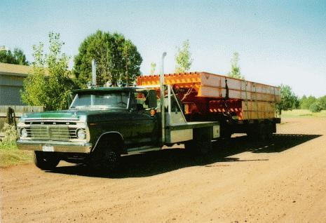

I take it then you have no bed or light as possible C&C, to haul maximum weight, I would like to see a picture of your rig/s. :)
Guys I will check mine to see if it is behind, forward, on center line of rear axle. Where ever it is, when weighed everything looks good, and tows good as well; it is a long bed.
This load was hauled from Lakeside, AZ to Prineville, OR. GCW 29,000 lbs.
