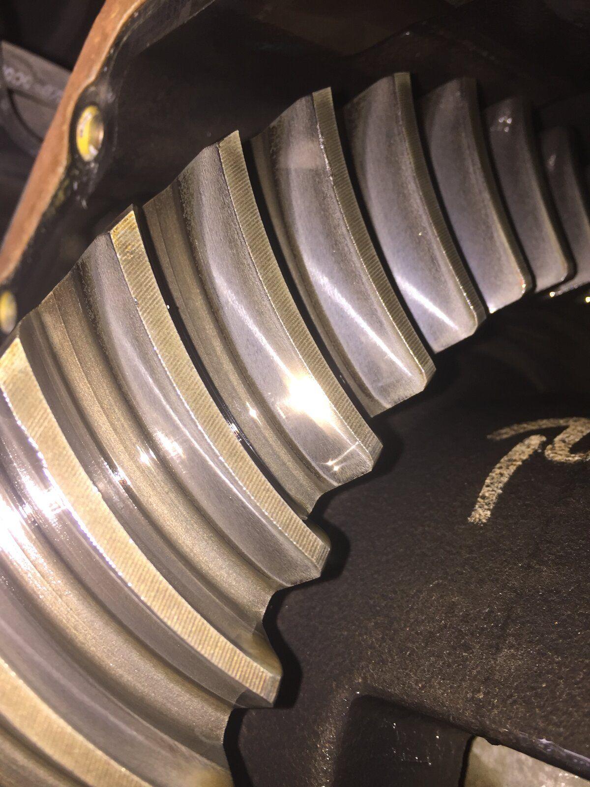

That's what I will do on this truck, its what I have done on previous trucks. 4 quarts is what I used, and its right at the fill hole, not running out, but close.
I started this thread for some insight on that fill level line ,which is approx. without measuring about 3/4" below the bottom of the fill hole.
