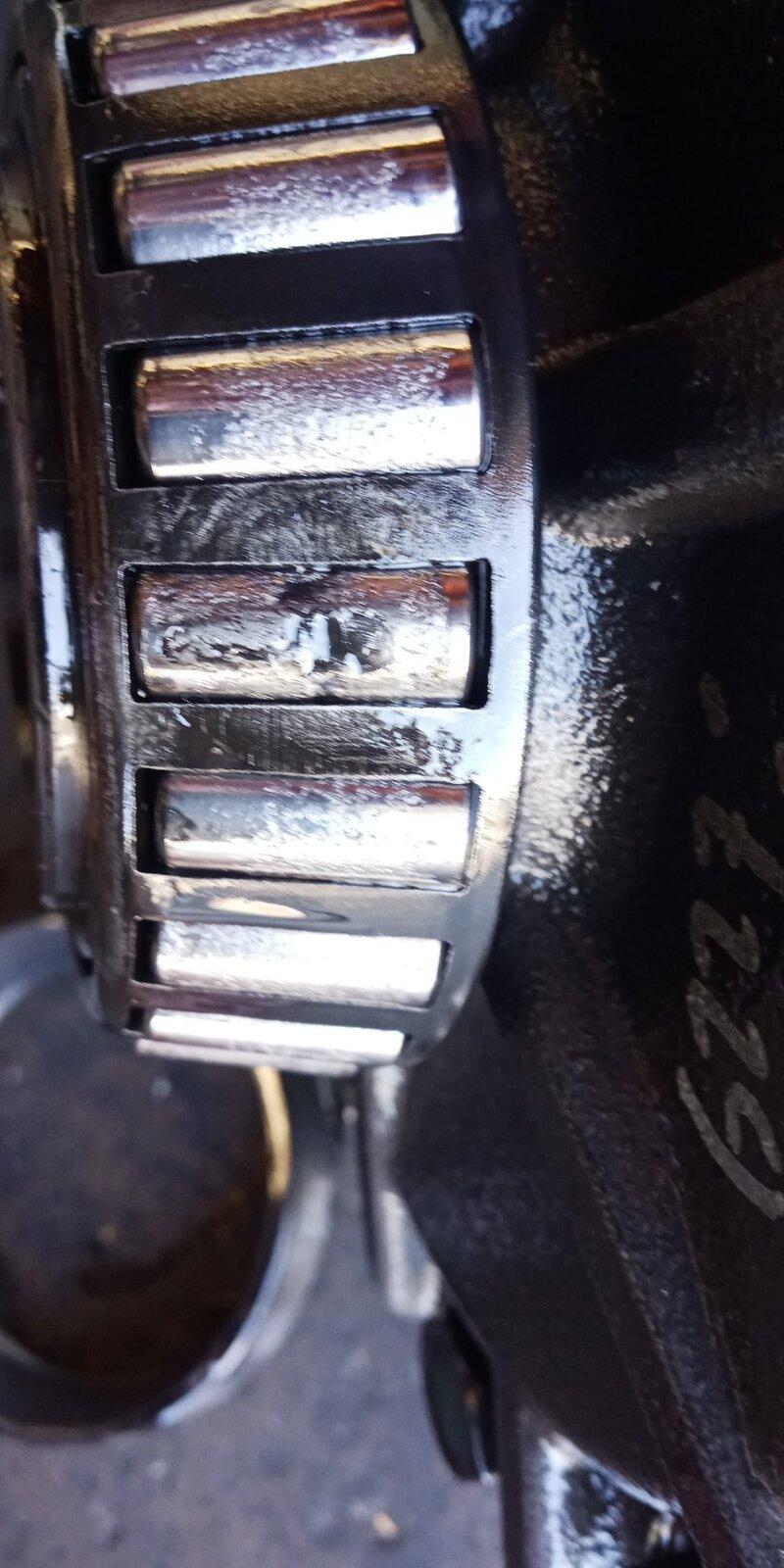

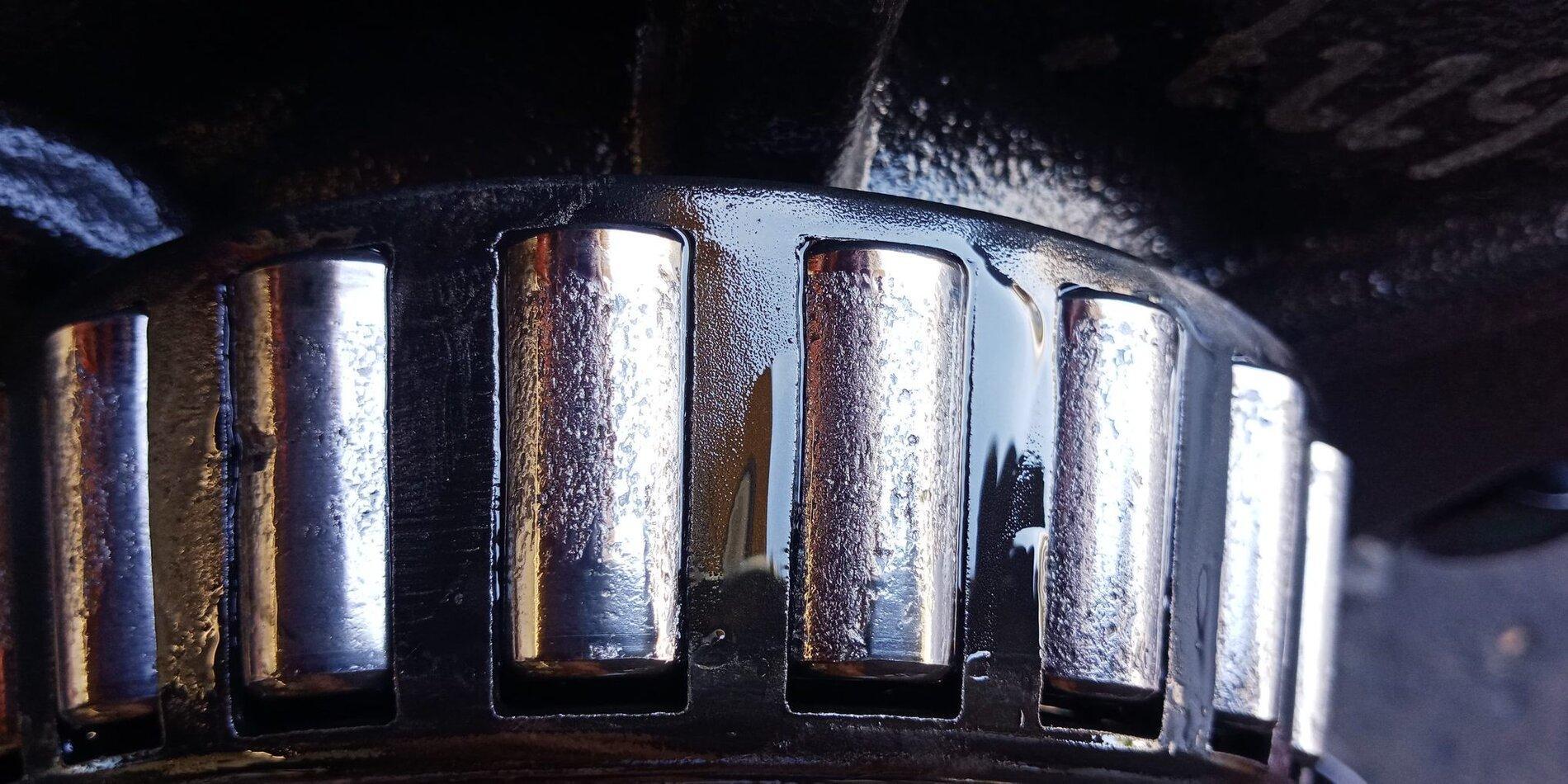

Here is the update. Both rear differential carrier bearings had wear and were replaced. Also replaced pinion bearing while in there.
I had just replaced both outer axle bearings last year so those were cleaned and reused. Just very small bits of metal in the bottom of the differential. Used Oriellys Master Pro GL-5 75w90, no LSD additive
No more roaring sound. Nice and quiet, well, as quiet as can be. I didn’t take a picture of it but where the ring and pinion meshed up it looked good.
