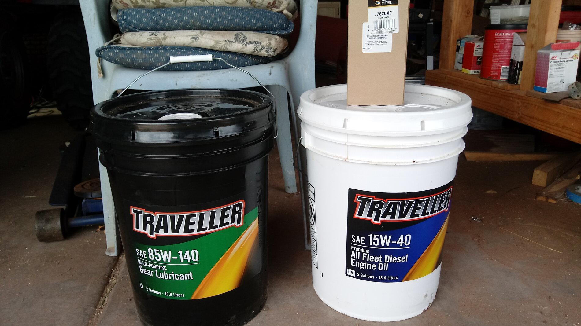

$12 a gallon for my rear diff oil (85/140), change every 30-36k miles. 358k miles on my oem diff seal, still dry.
