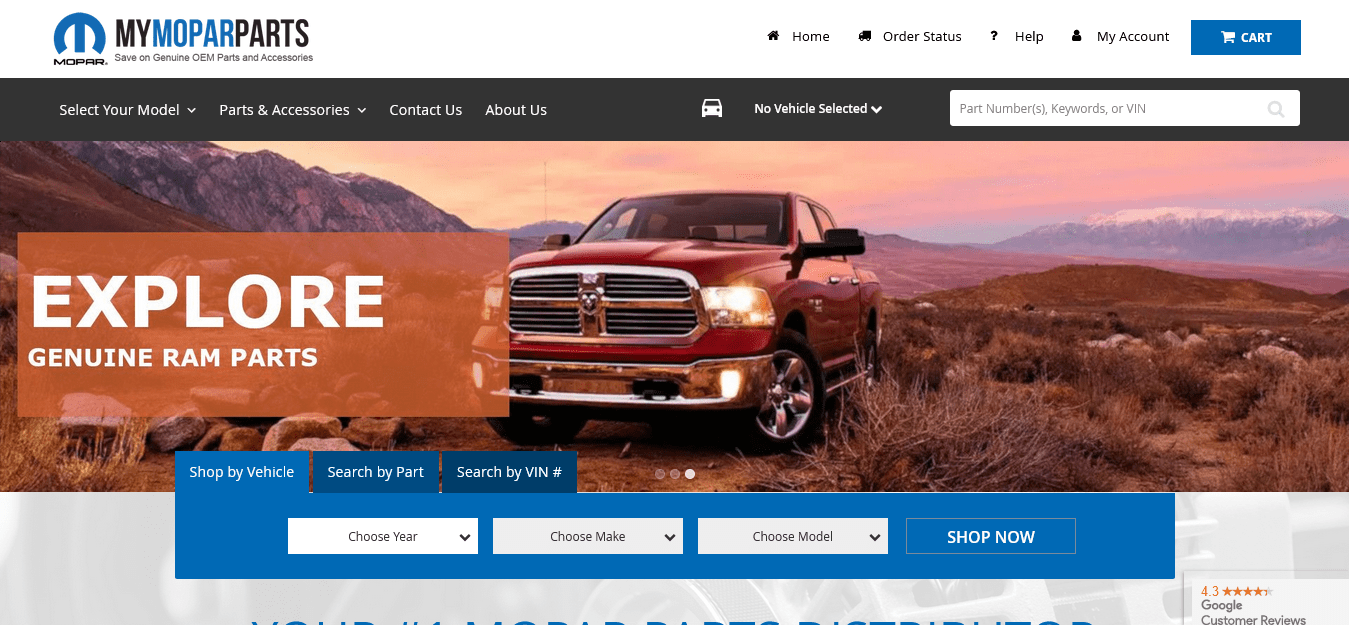

Use the search by VIN# tab.
I'm not so sure this is the panacea...
I just put my VIN in and the very next screen asks me to select the vehicle's engine and trim. I only get to choose from SLT trim in either V8 - Gas or L6 - Diesel.
Presumably the trim could be gleaned from a lookup in Mopar's vehicle database, but my truck has the Laramie trim which is not even an option.
Worse yet, the VIN that I typed in clearly indicates engine code "C" (i.e., 5.9L 6 cyl. Turbo Diesel High Output), so no database lookup is even required to verify the correct engine, yet I still have to choose.
Does not inspire confidence.
Edit: I should clarify, I used "mymoparparts.com"

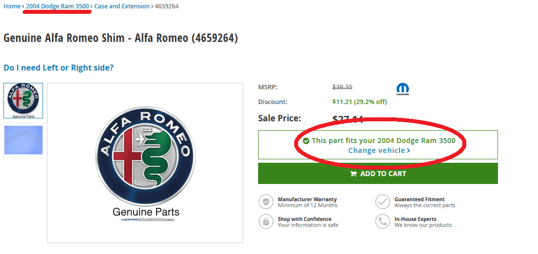

This one from moparonlineparts.com is the best. I looked it up in my parts fiche and it in the "Case and Related Parts - 6 Speed [5600] (DEE)" section. The description reads "SPACER, Final Drive, 1.26mm." Interestingly, when I opened the "Vehicle Fitment" tab, only Dodge and Chrysler vehicles were listed, not a single Alfa! But since I used my VIN, it has to be the right part for my 48RE. Right?
