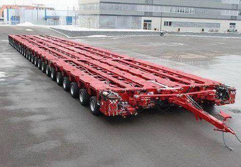

You might want to pack a lunch when you air these up and down:)

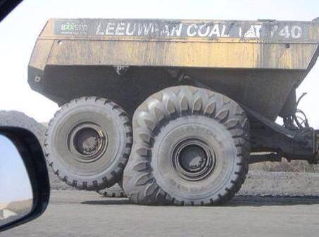

Maybe a bomb suit would be in order before you air this one down :D
