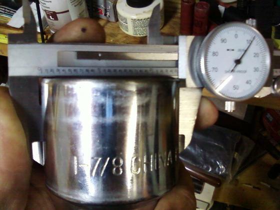

Finally found the thread with the socket dimensions, but can't seem to get the attatchment pics to show up

These are the tools that I used for my Dana 80:
The top is of course the socket I had to have turned down to fit into the yoke. If I had to do it again I would use an impact socket because they come in a six-point configuration. This leaves more meat at the corners of the nut after machineing. The size is 1 7/8"
The lower picture is the press I built to get the yoke back on. In past instances with other vehicles I was able to force the yoke back on with the nut. However, with my Dana 80 if I tried to hold the yoke so it wouldn't spin while forcing it back on the pinion shaft with the nut it wouldn't work. The combined twisting and pushing action would bind the yoke on the shaft. To get it to work I had to press the yoke up against the bearing then hold the yoke and torque the nut to 450 ft/lbs. I can't say if the 70 and 80 are the same. Maybe someone else knows.

If you remember can you check to see what the outside diameter is of the socket you have been using? It would be nice to find one that dosn't have to be ground or milled down to fit in the yoke. I wonder if there is a "special" socket made for this application, like an ultra thin wall design socket? I found OTC makes pinion sockets, but the smallest is SAE 2".
Ok, so I think this is the socket I've been using on the Dana 80. I don't have anything around without pulling the driveshaft to check it. But the O. D. is 2. 510". It's an 1 7/8" socket from Harbour Frieght (I know, I know, but the Matco truck is too dang expensive). I have several sets of 3/4", mostly cheap Chinky stuff. I keep my good SK set in my trailer... . it's older than I am, but I can't ever break it!! Good stuff!!
just to double check before I buy the 1-7/8" socket a standard length will work and a deep socket is not needed???
Before loosening your pinion nut, I would scribe a good mark for reference when you put it back together. Im almost positive that preload is more important than torque when reassembling the danas
Umm, the socket in the picture is only around 1. 5" deep, and has taken several dozen apart..... Preload is set by the shims on top and under the pinion bearings. Torque the heck out of it, and it'll be fine.
