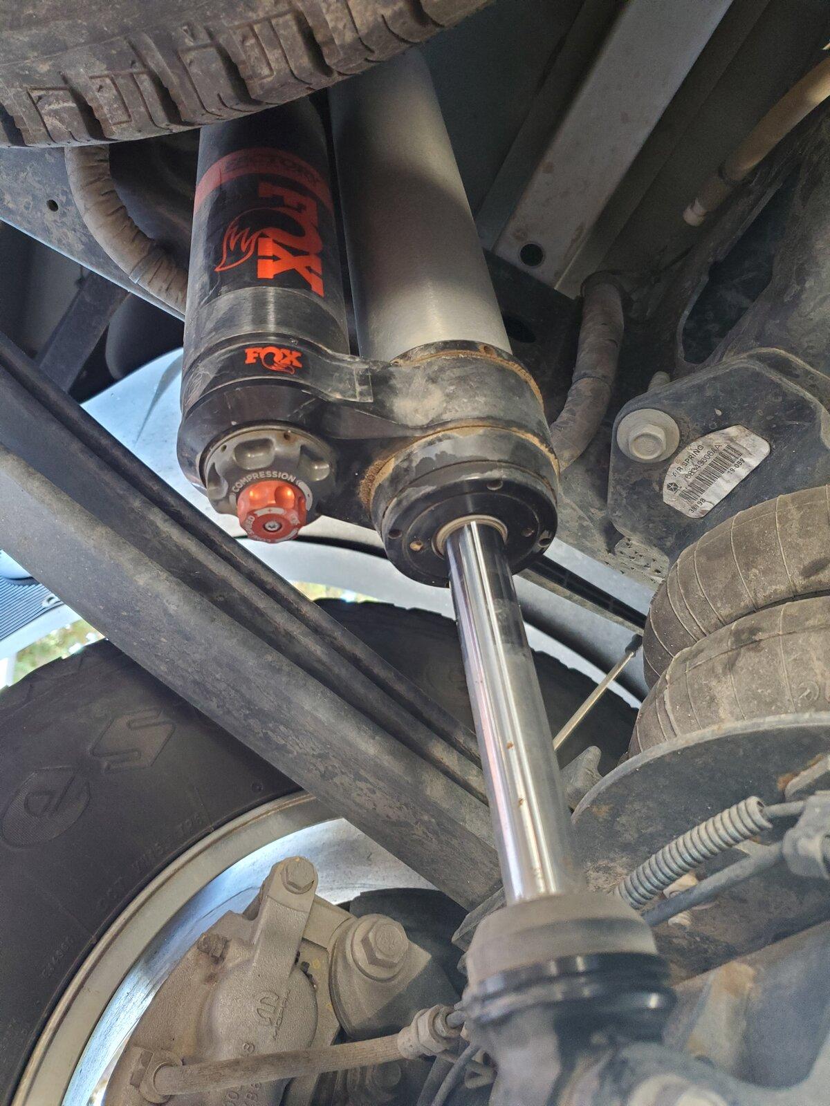

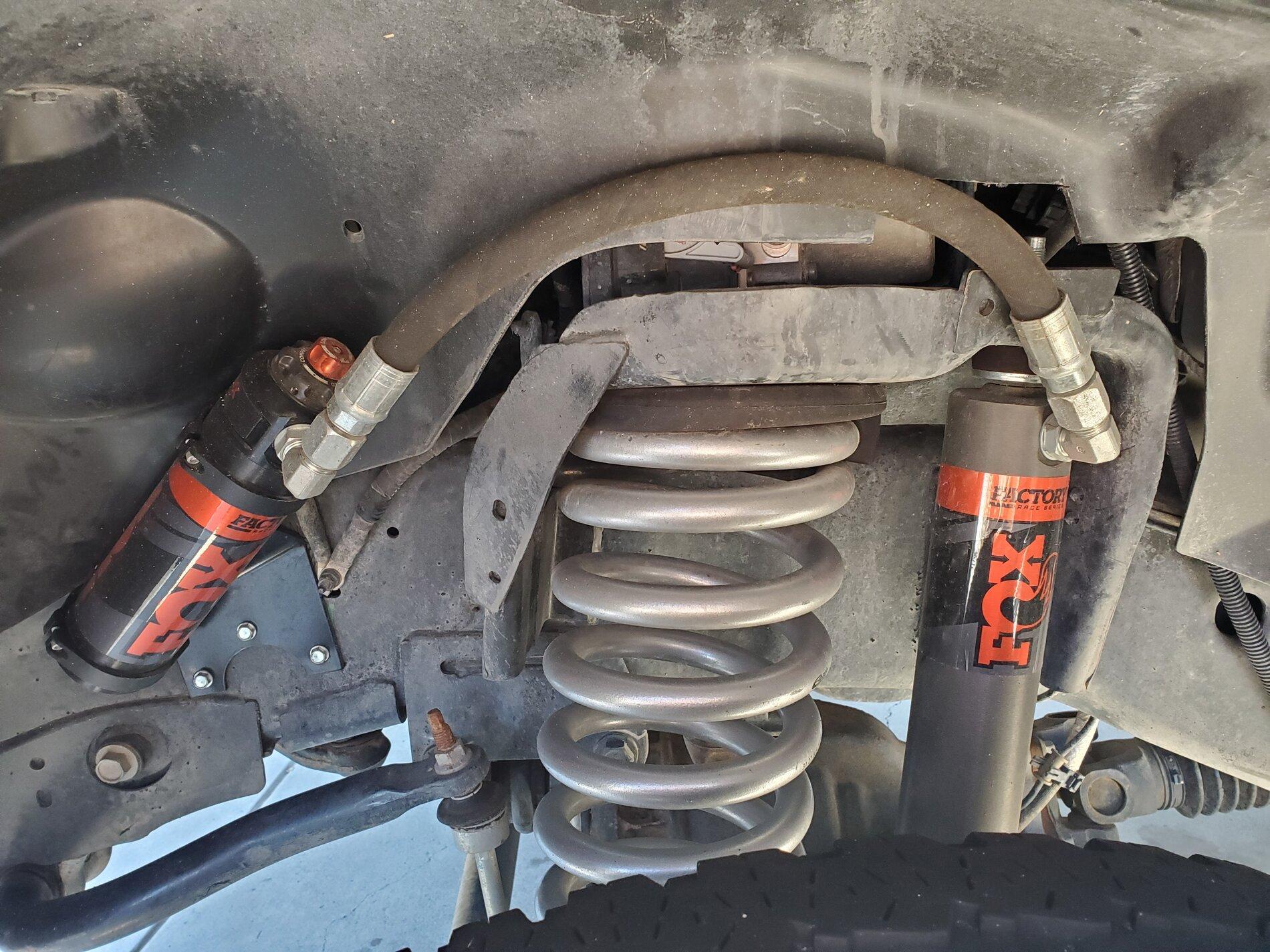

I don’t have the part numbers but FOX Shocks does have adjustable reservoir shocks for 2019 and later 3500 SRW trucks. Below are pictures of mine installed. They are very nice but expensive.
Specifically for air suspension models or did you install for non air suspension?
Earl
Mine is for 2019 air suspension.
Cool, I will look into those. If the shock length isn't correct, the air bag turns into the suspension limiter and they will eventually fail. So it's important to have the same shock stroke as OE to protect the bags from over extension.

Well Earl I believe you believe that FOX does not have shocks that are compatible with our air ride trucks. If you choose to ignore the shocks installed on my truck by FOX, that’s your choice. If, in fact, you want more and accurate information, why don’t you call FOX direct here in Southern California? They should be able to give you all the information you need. Regards, Harry
That is correct as they don't list air suspension on the 2500 or 3500 on their website or catalog. Also they specifically say no on 1500 air suspension trucks applications. Not ignoring you or your kick ass shocks. I don't believe they are fully compatible with stock unlifted air suspension trucks. I believe you have shocks for non air suspension 3500's. Do you have a manual or something that says they are completely compatible with unmodified air suspension 3500's? I will see if they have an email contact. If their site and catalog doesn't list them, I doubt they have anything. Hard to sell something you don't make public/advertise. For you I will email them, if they list an email. I'd be extremely shocked if they do, to which I will inquire as to why they don't publish them.
