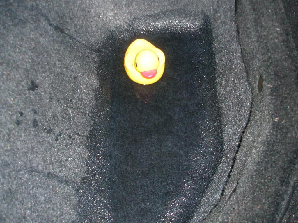

It came a terd floater last night and my rear seat and floor are soaked. I've been noticing a smell for a year or so but thought I had stunk up the truck myself.
I see where it was running down in the corners of the back glass from the top. It's a fixed glass non slider.

Had a very bad leak in mine. It was the third tail light gasket. Dealer told me it's a problem with the gasket on the fourth gen trucks. Just a matter of time if you have not had the leak yet. Should have been a recall in my opinion since it has or will happen. Amazing HOW MUCH water could come in that area. The entire rear floor under the seat, down into the storage bins and into one of the in floor storage bins. They silicone the gasket for the fix. At least that's what they did for mine. Checked it when I got back and no leak.

Picture is of the under rear seat storage well just a month after taking delivery of my new 2015 RAM.
