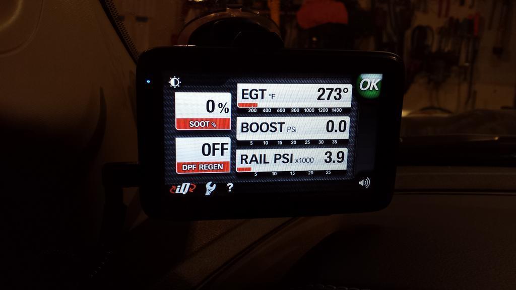

Many MOONS ago when I was working for a Large Heavy Equipment Manufacture we were wrestling with this idea. Should the owner/operator know when the engine went into regeneration of the Diesel Particulate Filter. The decision was made that they did not need to know and the operation should be seamless to them. Why? The reasoning behind this decision was they would be stressing out whenever the engine went into regen, especially if this happen right before the engine would be shut down for any reason. Would the operator shut down the engine during a regen process at this time or wait for the 20 to 30 min's it could take? Would the operator operate the machinery different in the regen process? These were only a few of the questions we had when this anti-pollution device was required for diesel engines. As you can see the automotive industry also has followed this same path that the owner /operator does not need to know!
With the updated emission system on the 4th gen trucks when using the DEF (Diesel Exhaust Fluid) the regeneration of the DPF is less and very infrequent compared to the 3rd gen and very early 4th gen trucks with just the DPF system
On the 3rd gen and early 4th gen trucks there was a simply way to understand if your engine is in regen or not was to add an EGT Gage and probe into the system. When the engine is in regen the exhaust gas temperatures could be as high as 1450F during this process or around 1250F. When the regeneration is not taking place the EGT's could be between 450F and 900F, if you are not towing.

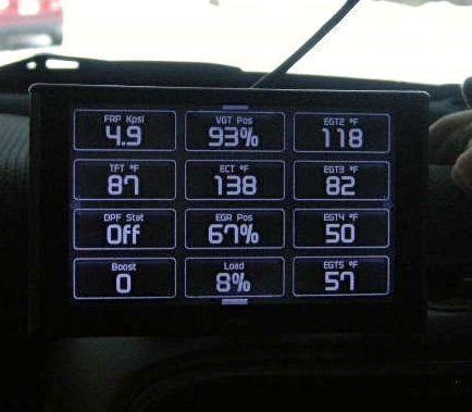

Best way to monitor things on these trucks in my opinion is with the Edge CTS Insight. Mine works great for indicating when DPF regen is active and monitoring a pile of other items.
With the way these trucks are setup on CAN-BUS i wouldn't be taping wires for nothing.
I have my Edge CTS 2 Insight set up to monitor 12 different PID's with the last columns on the right showing EGT's 2,3,4 & 5. and I think 3 and 4 are the ones that get the highest during a regen, I have yet to have any indication on the EVIC about regens so I assume the passive regens are taking care of the soot. Of course, I only have 2500 miles on the truck to date. Correct me if I'm wrong on any of asumptions.
