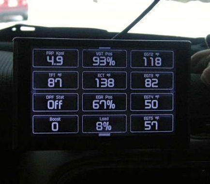

That is why I have a great copilot, it is her job to keep an eye on all those fancy numbers, *:eek: *
I wouldn't be able to drive if I had all those numbers to watch. :D Now I want one. Is there a unit like that which records data over time?
Hmmm if you were flying your own plane and it failed from lack of oil pressure.. I bet minutes before YOU crashed and died you would have wished you paid more attention to the gauge.. (remember the Cummins Ram gage is LOM). Just to Illustrate. If you want to guess at what happening under the hood that your preference ,IMO don't come to the WEB *****en and wanting help with no more then codes or pictures. The IQ can be programed to log info..

If you pay that much attention to gauges, you shouldn't be driving at all. The older cummins had pillar gauges. I put my phone up on the Ram phone holder in the centet of the dash. It's not a distraction. Less of a distraction in fact than trying to scroll through the EVIC screens
The OIL PSI reading in the EVIC is L-O-M Your OIL PSI will drop over time form Bearing wearing or sludge . Oil Pump failures are What ! 1 per 1/2 million today under warranty. Need only look at live gage occasionally. If you own ecodiesel Live gage is almost mandatory , 3 more pukers this week in calls alone.. the 3.0 is hero-zero status, My guess it will go done in history with the 6.0 rankings.
TC, that is why with 53000 miles on my ECO D *went to 2500 for the rest my of travels and towing the trailer. *:)

Funny, you recognize your illustrations but no one else's. One of the things you learn in flying is sensory overload and division of attention. That's why instrumentation is standardized. It requires less attention and allows for division of duties. The other thing that's emphasized in training is keeping your head out of the cockpit. You should also take note that the oil pressure guage is about 1/3 the size of the primary instruments. That's because it's more important to fly the plane ( or drive the vehicle) than to be distracted by ancillary activities. About the only time a pilot would notice low oil pressure in flight is after he noticed a rough running engine or heard noises. If you doubt that tidbit of info read a few NTSB reports. The rest of us may not be up to your super human abilities.

TC, I know I came off as being overly critical. I regret that. Using a pilot was a good example, but for another reason. I'm sure you remember that the majority of pilots you ran into didn't really understand WHY they did what they did. They did it because that's what they were taught. Thats known as learning by rote memory. That's the case whether it was actual flying or engine management. For most folks it's the same with a vehicle. Give them too much info ( phone,gps, etc) and they obsess over it and fail in the primary duty of driving. In addition, given info they don't FULLY understand it raises more questions than it answers. That's why Gami Injectors offers a $1200 three day course in Lean Of Peak engine management. The aircraft owners were taught 100f rich of peak and never understood why. It's obvious you have tremendous knowledge in Diesel engines and you easily interpret the info. Even though members here are enthusiasts, it doesn't mean they are at your level of competency.
I agree. I also think that its very important to occasionally know engine conditions... and its up to each individual to measure the safety and depth of that knowledge. I will use another example back a few years this women rented a snowmobile ,Snowmobiles require much physical ability this women had her 7 year old son on the back riding 2 up She lost him 1/3 of the way up the mountain when she realized he was gone she went frantic, We were call in Search/Rescue to find him and we did another rider pick him up and brought him into town and left him with police, When she was united with him she was *****'en and moan how snowmobiling was dangerous.... We'll I don't put up with much and I ask her that she should have NEVER been on the Machine in the 1st place... If her ability mounted to devoting so much attention to the operation of the machine that she didn't even know she lost her rider , She should have excised more caution or drop it all together. she created her own hazard. I may come of as a jerk at times but its all in the betterment of My fellow Man.
