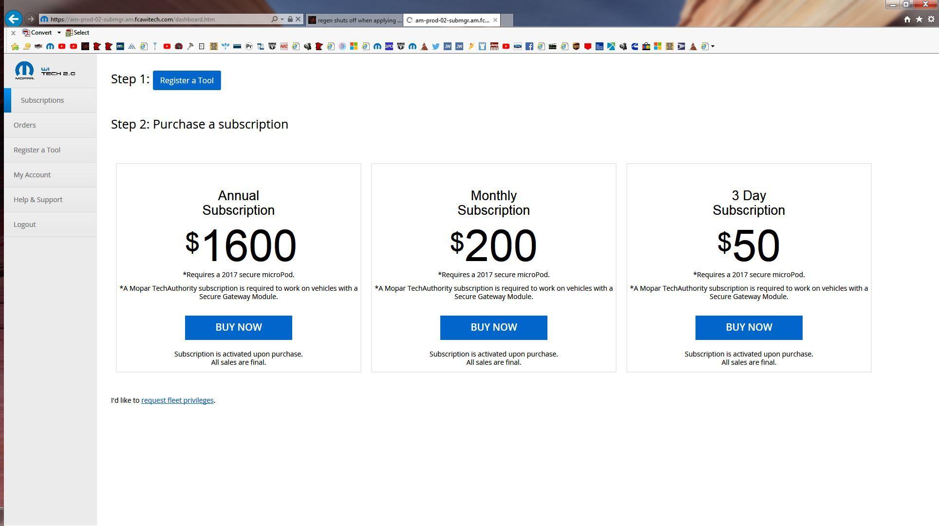

truckmen, when's your next trip to Minnesota... The Flash to fix the brake Regen 3 years old, Your truck very out dated, The Dealers Hands are tied , FCA has ALL Dealer flashes to mandatory ONLY or its $.. Even TC Diesel has to pay FCA Blood Money for Flashes but its considerably less than Dealer rates.

Newsa , What happens when You have 3 Modules updated and 5 lighting bolts that communicate with the rest of the tied in system and it throws the CEL?. Now the communications throws more codes. Every Update states the same warning, (ALL must be updated) to current versions.
The dealer will be charged for the Additional 2 if NOT authorized to do So, I know its NOT right, but thats the Policy.
