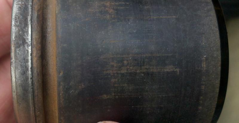

I pulled the right rear one apart to see if the cylinder was scored & this is what I found. I got the truck with 30k on it, I cant imagine there were replaced under warranty???
Its phenolic with a metal cap.
Is it factory???
Great photo... its scratched and would damage a new seal that would run against the piston... I can't tell if it would be something that I might try and repair... if I couldn't catch my finger nail on it... as I drug it across the scratch I might use a 600-800 grit paper and see if the scratch can be removed... or I'd go to rockauto.com and just order replacements... but the way they now are... is not acceptable... for re-use...
