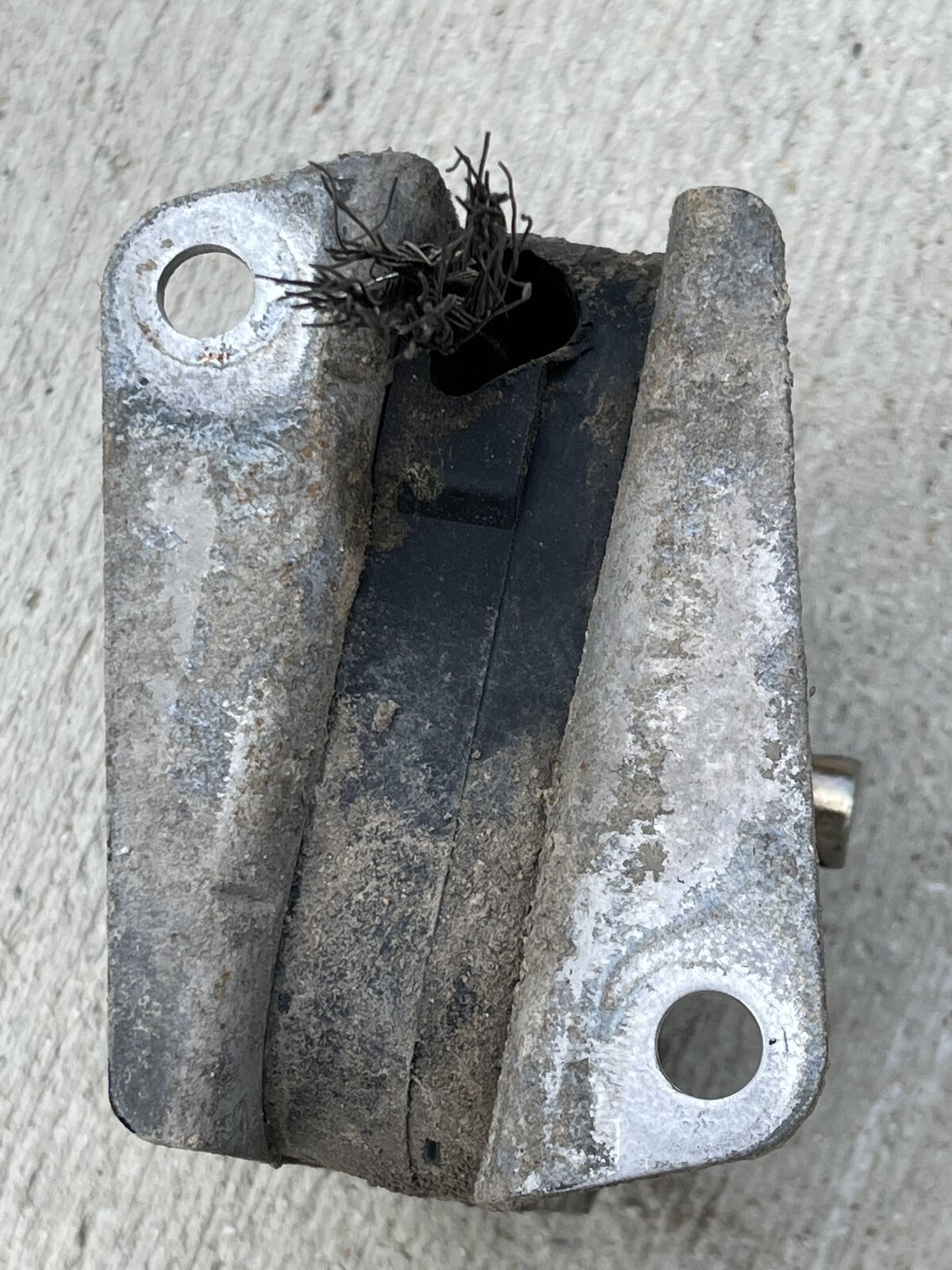

Meant to post this pic a while back, but just got around to transferring it from my phone to my computer. In looking at it, you can see how frayed the cable is, with the fraying extending down into the housing. You may have to blow up the pic, but you an also see how the cable cut into the plastic around the hole where the cable passes through. A few people told me they thought the spare tire was stolen, but to me this picture is proof that there was some violent, high speed trauma perpetrated on the winch. The only culprit I can think of is the tread that separated from the tire. Had this happened when I wasn't pulling a trailer I would have seen the spare tire sliding out from under the truck. With the trailer it was probably off the road by the time I had a sight line, and I was watching the tread bouncing from my side view mirror and concentrating on safely pulling off the highway.

Man, that's a lot of damage! I guess I got off relatively easy. Tallying it up it looks like it's the blown tire, the spare tire/wheel, the driver side wheel well cover, the driver side headlight assembly and some minor bends to the fender. The fender was slightly bulged out and not really noticeable, but the bottom part of it by the door would make contact with the door when I opened it all the way. I was able to leverage the fender back in place in that spot, leaving a worn area where they rubbed. The headlight was probably the worst of it. Both were fogged up because of age, and before this incident I was planning on getting the $25 rubdown at Walmart. With the broken assembly that was out I opted to replace both headlight assemblies. Since the truck is almost 20 years old I went with the Depo brand from Geno's instead of the OEM Mopars. They work well, but they extend out farther than the OEM assemblies. Not sure why. They fit perfectly when I installed them, but the old lenses are almost flush with the fenders and these stick out about 3/4". Totaling it out I think this will cost me less than $800. The headlights were always a sore spot with me since I bought the truck because they did a poor job in terms of lighting distance. The bulk of the light hit the road about 3/4 of the way across intersections. So when I installed the Depo assemblies I went ahead and raised them a bit. Now they shine just past the far edge of intersections, and when the brights are on they shine a lot further. I'd like to raise them up some more, but I'm concerned that the brights will be right in the eyes of other drivers until I switch them off. My memory of those old fashioned round glass headlights were that they shined much, much further, but that could be faulty memory. I still might raise them up a few more degrees and just try to be more conscientious about dimming them back down when there is oncoming traffic.
