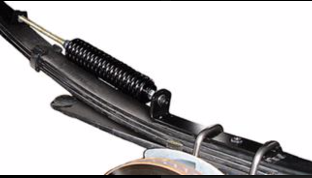

The part that was changed was the front adjuster stud bracket. Previously it was an L shaped bracket that fit under the u-bolts. Some folks didn't re-tighten the bolts enough, so Roadmaster replaced the L with parallel brackets that fit outboard of the leaf springs, so people didn't have to disturb any existing hardware. I've attached a generic pic of their older bracket mount (I prefer it, as its a bit more elegant).

And a lil anti sway :)
Well the 2 sides are not connected so its not acting like a sway bar, seems like the increased spring rate is reducing sway but I wouldn't consider that to be a true anti sway. Unless Im missing something????
Another thing it does,it gets the weight off the thick overload leaf so the ride is softer till it hits the overload
