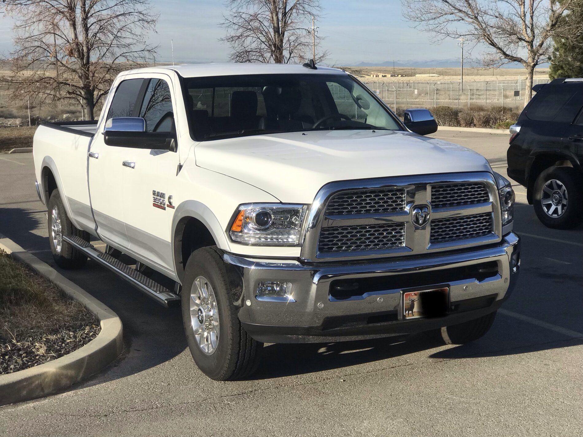

I have put them in my last three trucks and love them! The ones in my '16 Longhorn 2500 are simple plug and play, no splicing wires like the ones in my 06 2500 and 09 1500. A lot of people get frustrated installing them if they hit the pinch weld. Then after a lot of cussing get out the grinder or hammer.
The simple cure is to install them without the motors, see where they touch, then take a 2x4 about three feet long as leverage. Place it between the pinch weld and the board and put a little pressure on the end of the 2x4 with one foot. Check to see if the board and see if it clears. If not do that until it does and install the motors. Wifey loves them as they are a wider platform and further away from the rocker than the stock running boards. Much easier to get in and out of.
