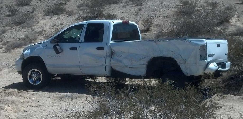

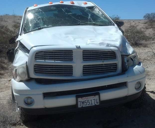

OK. so I was broadsided by a semi-tractor at about 40mph. Impact occurred from behind my drivers seat all along the bed as i passed in front of his huge steel front bumper.
The impact rolled my truck 3 times landing on it tires. The whole sequence likely too less than 10 seconds. (Yes, I walked away, and now have proof these trucks are truly built "RamTough")
Stopped rolling, tires down, about 75 feet from from impact, engine running at red line for about 5 seconds until I realized what the high pitched sound was. Removed foot from throttle pedal and turned off engine maybe 30 seconds after impact.
The good part - When the tractor's bumper dug into my left rear wheel, the differential stopped, the first weld on my aluminum drive shaft sheared clean off, right in front of the diff.
The drive shaft then slipped out of the transmission/transfer case tailpiece and fell to the ground as i rolled away. Cursory inspection of tailpiece showed no obvious cracks or breaks.
The engine however was inverted 3 times, running at red line for maybe 3 seconds each time. When I removed my foot from the throttle, it idled down normally, and after 5 seconds I turned off the motor.
Considering the engine and transmission were in normal driving mode at the time of the accident, how much damage was likely to either component? The engine compartment and trans area where not damaged as far as i can tell. There were still no fluid leaks a week after event.
Wondering if i should try to buy back my truck from the insurance company and salvage my sweet running 5.9 and my recently rebuilt $5K 48RE. What would you do?
Any and all advice and experiences welcome.

You got nailed by the looks of the truck. More medical conditions may arise as any physical therapist or doctor will tell you.
