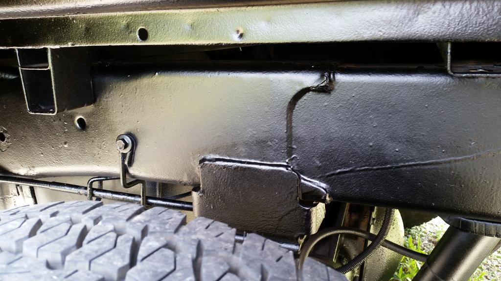

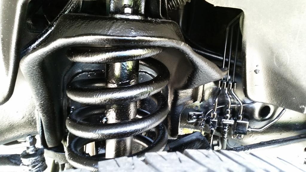

This was posted in the other thread linked earlier. But, here is the frame on my '07 after living it's entire life in PA. It was treated at Ziebart the first day I owned it and every year since.
Please go take a look at an untreated 11 year old frame from NY, PA, Ohio, or anywhere else in the rust belt and compare it to mine.

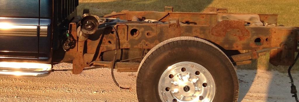

Here are photos of my Michigan '02 Chevy with the box removed that was taken in 2014.

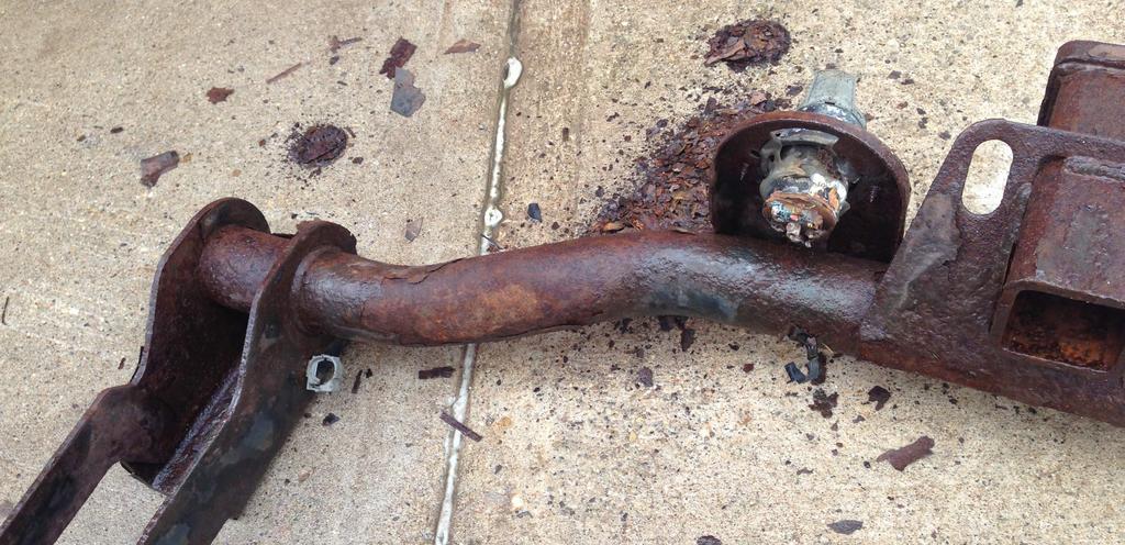

and the hitch
This truck was not rustproofed or undercoated beyond what came from the factory and I believe I did a pretty decent job keeping it washed & rinsed of salt. Note that the trucks cab corners and rocker panels are still original and looking good at that time (they started to rot through in '16).
