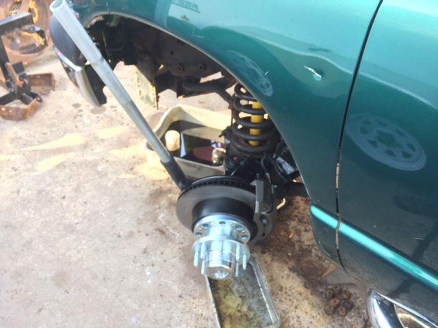

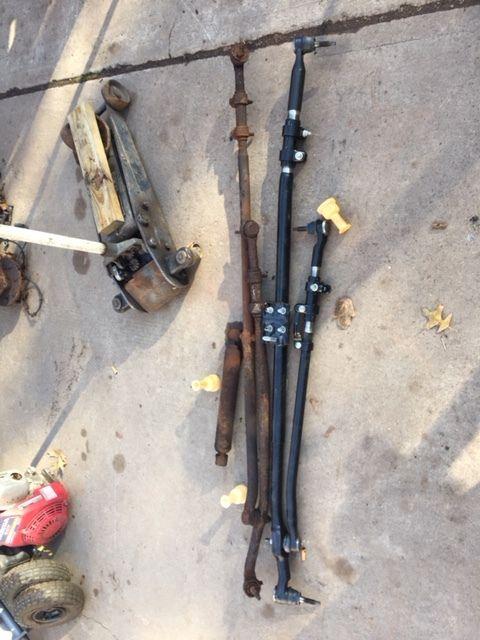

I just replaced upper and lower ball joints, universal joint, rotors, brake pads, brake fluid, unit bearing drivers side, tie rod end driver side wheel, on both sides. They were very difficult to get apart but after pounding away with large hammer they finally gave up. they universal was very hard to get out and after pushing it out 1 side and removing cap there was not enough room to get the joint out so I torched it and ground a small amount off of axle so new one would go in. It was a bad casting job. Got it all back together and bleed brakes aligned toe in and it all works great.
During all this, I changed transmission filter and fluid and engine oil and filter with Royal Purple. Cleaned air filter and oiled. Truck has 205,000 miles and has given very little trouble.
The Spyntec hub conversion looks great on the truck. Good to see what the kit looks like assembled and mounted. Thanks for posting the pics. Learning as much as I can in anticipation of hub bearing & ball joint work in the future. The Dynatrac Kits and Spyntecs both look to be good choices.

Just completed doing the front end of my 03' dually. Rotors,caliper's,hoses,brakes,shocks,springs,upper and lower ball joints,08' steering upgrade and Spyntec lock out hubs.What a job!!!! Thanks to NJ DOT with all the crap they spray on these roads during the winter months!!!!

The main reason to choose the Dynas was that they are the shortest available hubs on the market. Some dont like hubs that stick out of the wheel so far.
My hub kit is Spyn, and I chose them because I thought they offered the best value, and I was able to buy them from a 4X4 shop not too far, so I saved on shipping and tax. The only frustrating thing is that months after I took the plunge, they came out with the shorty kit. I take comfort knowing that my kit uses all Dana 60 shafts and wear parts, except for the seal, which is an industrial item. I already had them apart to repack the bearings, and spyntec was excellent with parts and answering the phone.
