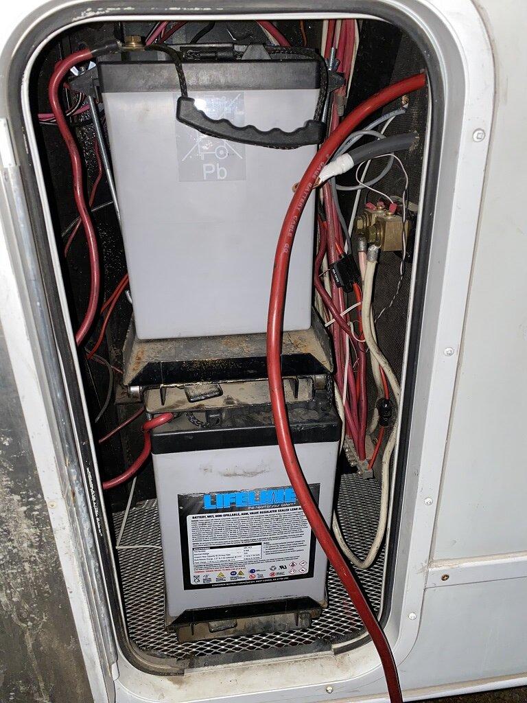

For your upper battery mount, having cut out that structural steel, I'd recommend a cross brace to go across (side to side looking, forward/aft on trailer), then down at an angle (clear the lower battery) and attach to the frame.
Thanks for the suggestion. I will call a mobile welder to look at doing this.

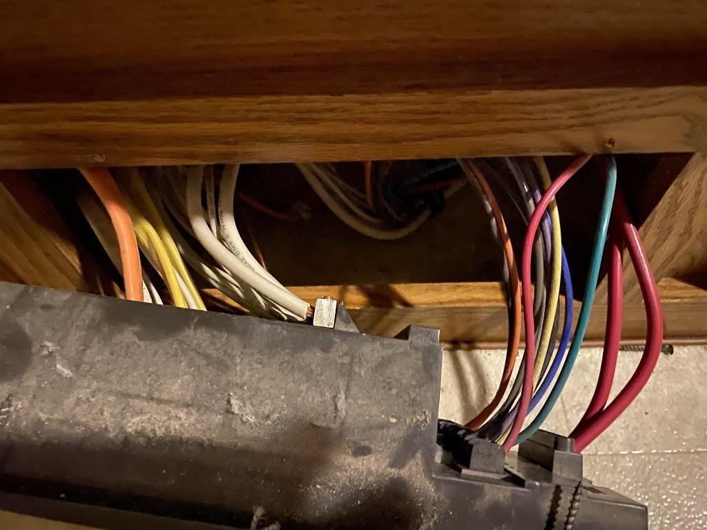

Wires to the battery from the converter: Ugly. Finally made some time and got help to knock this out. And the wires are more ugly than I thought!
I emailed Lifeline and asked them what their batteries could take for amps during the bulk charging stage. In other words is moving the converter really going to be worth my time as a project to reduce and get the most from genset run time. I was pointed to the technical manual ... a 100Ah battery can take a 500A in-rush charge current. (These are 220Ah.) Guess we will see what the 60A converter can really sustain in the "bulk" charging stage without a 1.5V drop on the wires. :D Can't put much of a bigger converter than 70 Amp in without a 20A 120V wiring to it. A 80 Amp converter requires 20A 120V wiring.
I mis-underestimated just how badly the wiring is. No NOT a 20' run like I thought! I noted other RV forums going on about the power distribution center being between the converter and batteries. Verified... It's 20' plus 8' to go to the power distribution center on the other side of the RV and another 8' back to the other side. Plus some height change... It's at least 36' of #6 AWG wire between the converter and batteries. o_O I confirmed this with the voltage drop I was seeing and an online wire gauge calculator. Checking for a bad connection and confirming the wiring below.

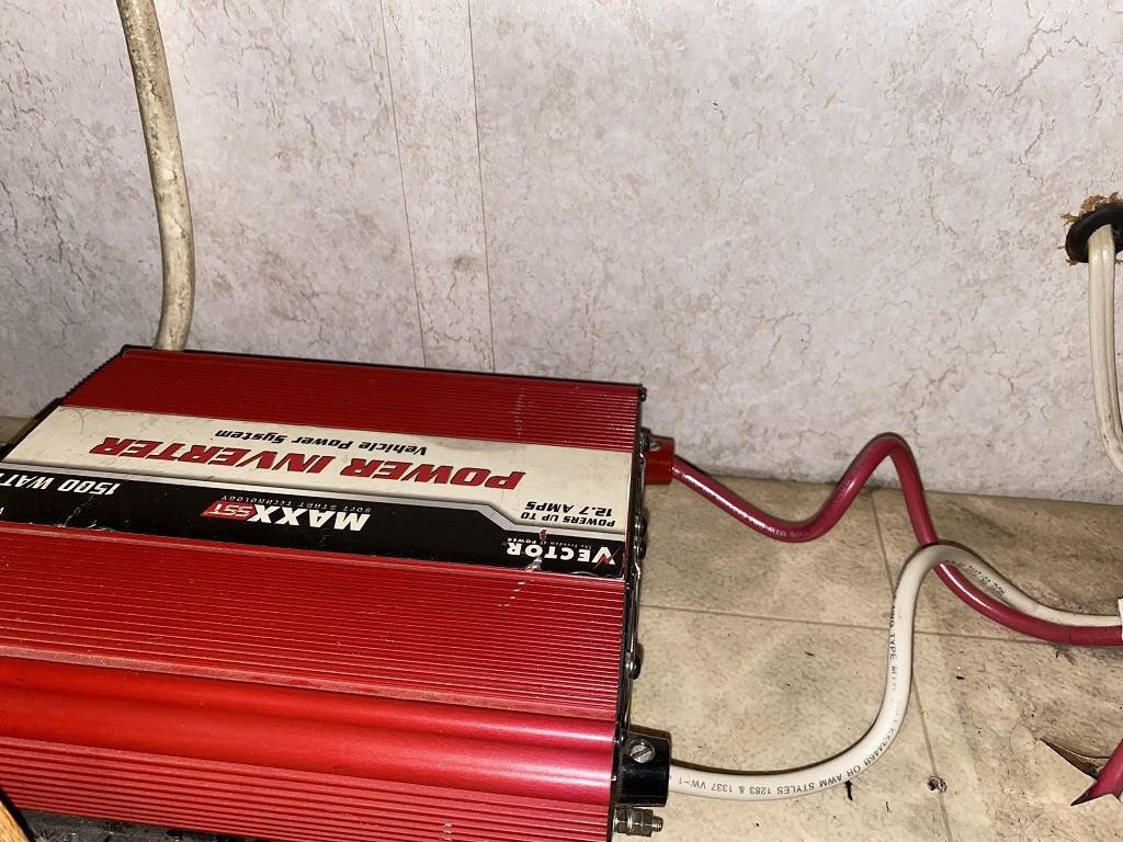

Well the first thing we did was remove the power converter and install a 1500W inverter I had laying around in it's place. I put the screws to it and failed. Wouldn't even crank a 750W setting on a heater and the "lights in the RV went out" till the converter tripped off on low voltage. Ok tried a 500W lamp. Constant low voltage alarm, but, lit it up. So 52A 12V draw: 12v at the batteries, 11V at the power center, and 10.5V at the inverter. Yup 36' run of #6 AWG wire eating 1.5V. :mad: Only need 100W from it now, but, considering putting it by the converter as well.

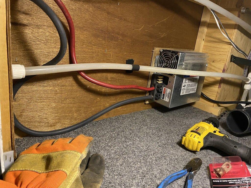

Next we put the converter close to the batteries and used 2 Gauge Battery Cable. Well 1 Gauge on the ground as that's all that was in stock locally. Had to thin the wires out a little at the converter as it just wouldn't take wire that big. Pass through storage area. Next is running a new AC outlet for the converter.
In progress as the battery cables are also being upgraded from 6 AWG to 2 gauge. Yes, bypassing the small RV busbars.

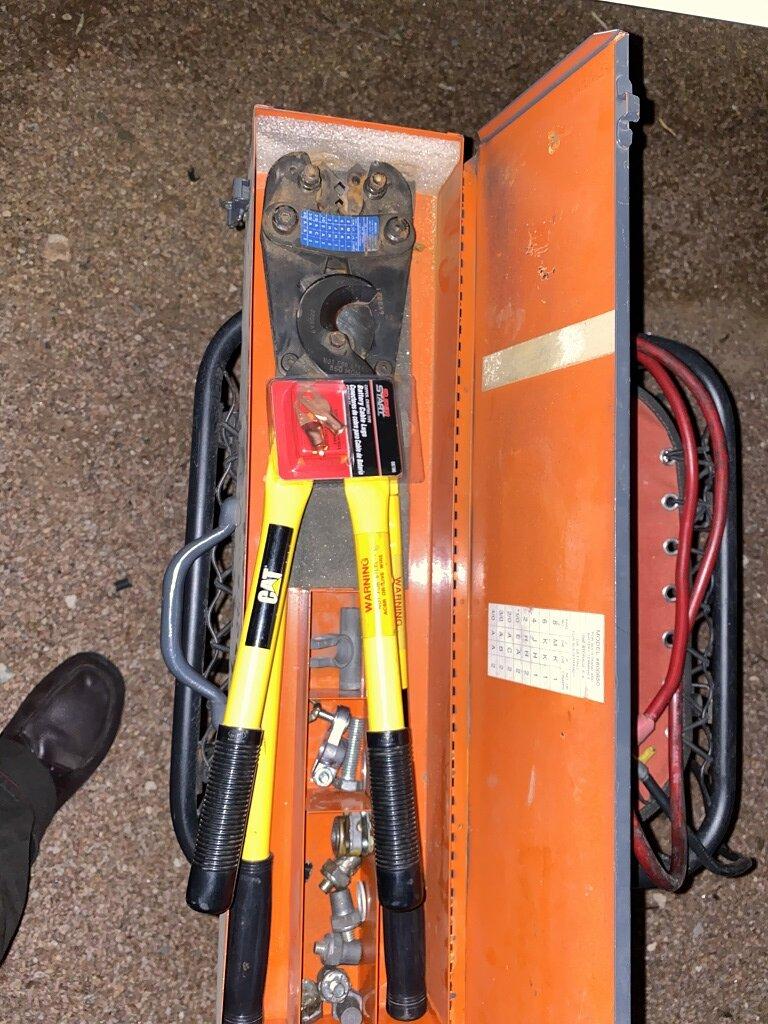

Some tools to "roll our own" cables.
