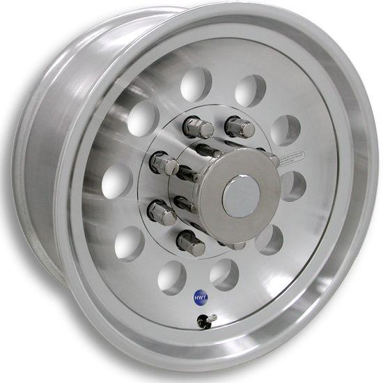

I used the following 17. 5" wheels available from Trailer Tire & Wheel Supermarket. These wheels came with 9/16" lug nuts appropriate for the wheels and 7K Dexter Nev-R-Lube axles, center caps, and with the tires mounted and balanced (your choice, weights or Equal). Installation was a straight bolt-on. Since the spare G614 had a 2004 date code, I replaced the spare with another 17. 5" Michelin XTA as well. In addition to the Michelins, this vendor can also supply Goodyear, Sumitomo and Cooper Roadmaster tires in the 215/75R-17. 5" size.

Oh wow! Nice wheels, mine are plain, like Dickies:) How about the load range J, is that just a typo?
Nick
Ok thanks, I haven't seen a J rating before. I did a search on tire load range ratings and per; (Tire and Rim Association) the J rating is 18 ply, they don't use I or K in the rating system. So if my H/16ply (WestLake made in China) are rated at 4805@123psi and your Michelin's are J/18ply rated at 4805@120psi, they have a substantial safety margin built in. That is probably one of the reasons why Michelin users swear by them.
