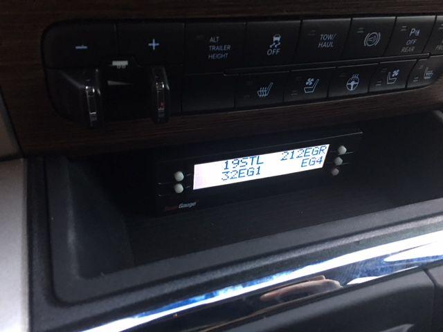

Yes, I'll keep you updated. I really like the ScanGauge because of the size and the fact I can mount it easily inside the center cubby (see attached picture) without drilling any holes or having it in my line of vision like the window mounted units. It worked great on my old Ecodiesel and truly believe Linear Logic will provide all the codes needed to make it as useful for the 6.7.
nice place to put it, except I don't have the center console. I have a Blend Mount for the mirror that I used on my Nissan Titan, then my F250...haven't gotten around to see if it works on the Ram.
