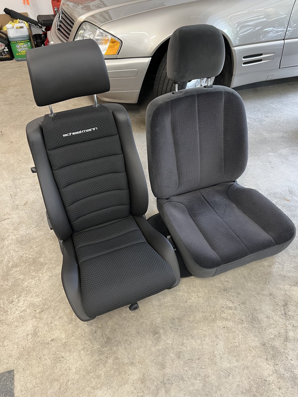

Sharing an aftermarket seat installation in my 2004.5 dually.
A little background- I've been looking at replacing the stock seats for a number of years due to them being very uncomfortable for me. I've looked at air ride, other manufacturers, even used later model. All have pros and cons.
I found Scheel-Mann seats during one of my searches. All reviews were positive except for the price. These are not cheap at all, but seem to be extremely well built. The old seats are about a third the weight of the new.
https://scheel-mann.com/
I went with the Scheel-Mann Vario F seat for both driver and passenger.

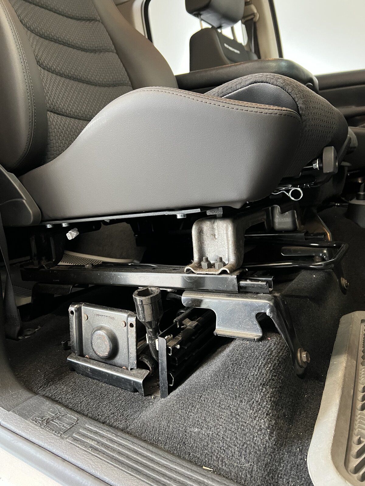

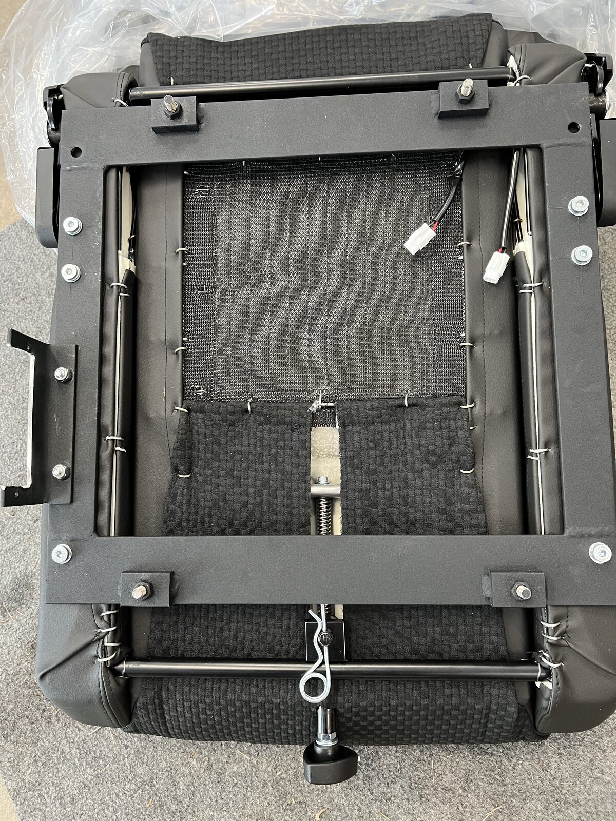

I also found a company out of Utah called Wedge that makes adapters and brackets. For the 3rd gen. Dodge, they have an adapter that allows you to use your factory power drivers base, and manual passenger base.
Scheel-Mann imports into Portland, Oregon where they have a showroom/warehouse. A quick trip there to actually sit in them and check them out and we made the move to purchase. I will tell you the folks there are easy to deal with and very helpful.

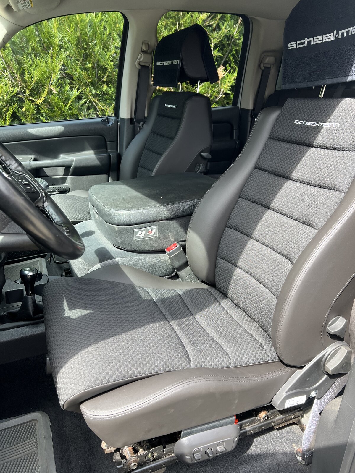

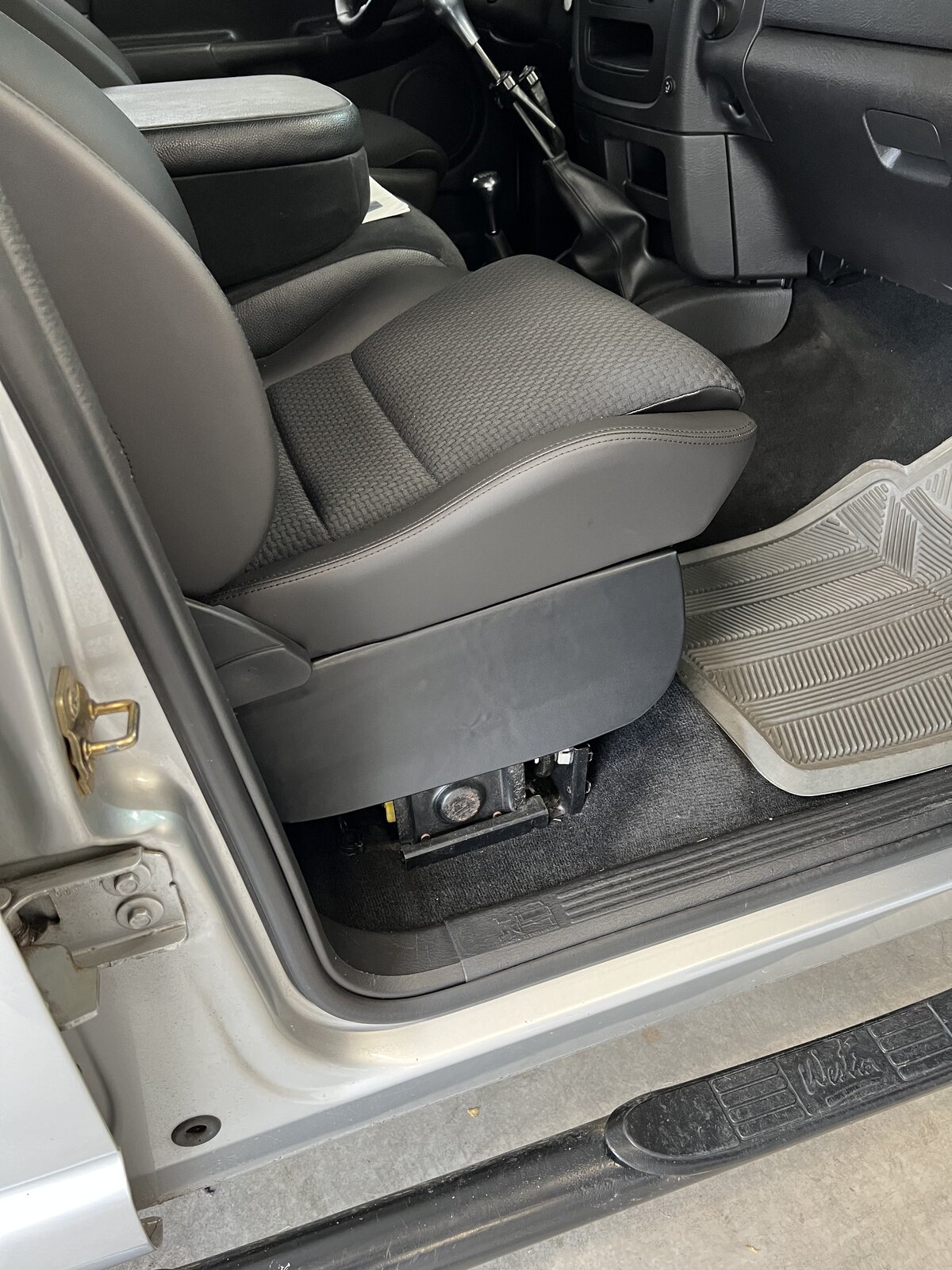

Install with the Wedge adapters was super easy. The "flap" on the outboard side of the factory seat that hides the mechanicals for the drivers seat and the jack/tool kit on the passenger side needed to be fabbed. Some .125 plastic sheet, black vinyl, and 3M 77 spray glue worked well to make new "flaps". The Wedge adapters had a bracket for the seat controls.

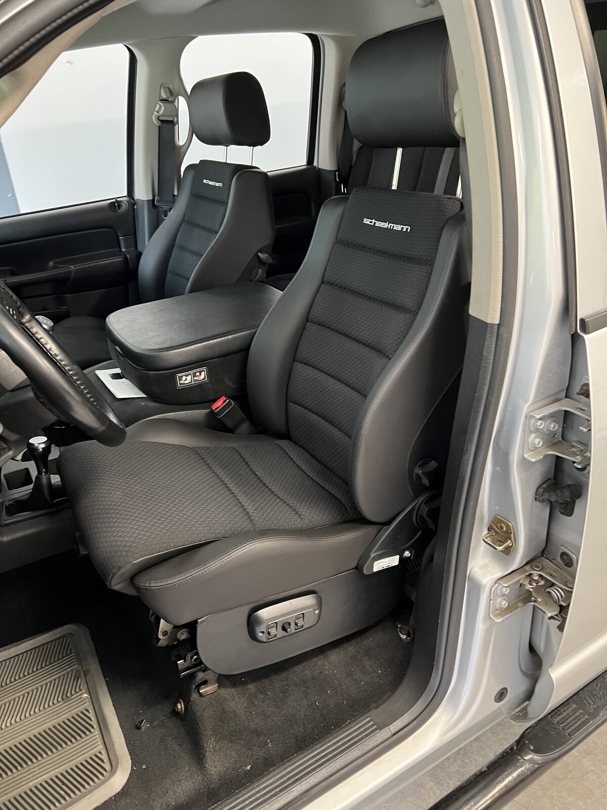

Overall, I'm happy. My wallet isn't but my back sure is. These are extremely adjustable. They are firm, but I hear they soften up with use. It may take these a while to soften, as I only put a couple of thousand miles on this thing each year. The comfort these seats provide is light years past the stock, and much better than any other seat I've used.
I won't say this is a route I recommend for everyone, but if you want a very comfortable, adjustable, well built seat these may be an option for you. Pricing is available on the inter webs. I paid retail with heat and rear cargo nets as the only options.
Some pictures. I have to apologize for the messy truck. I normally keep the carpet much cleaner.
