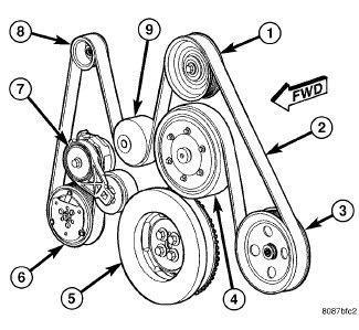

Now y'all got me thinking. I know..... that is dangerous... I have a Jacob Exhaust brake. I have been told that if the pump ever goes out, I could bypass it with the belt and fix it later. Now I am thinking I need to carry 2 spare belts of different lengths??? One to include the pump, and one to bypass the pump??? I only have 36k on the belt, but it is 5 years old. Maybe I need to be looking at this???
Thanks... ... Steve
That's what I did when my pump went out. When I finally replaced my pump, I couldn't find my longer belt and bought a new one. Then, naturally, I found it, now I carry two. 10' of belt, that's a lot to wrangle in tight spaces!
