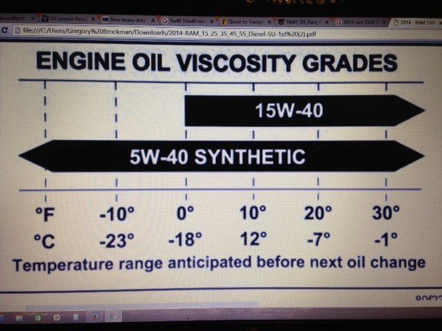

Engine Oil Viscosity (SAE Grade)
In ambient temperatures above 0°F (-18°C), we recommend
you use SAE 15W-40 engine oil such as MOPAR®,
Shell Rotella® and Shell Rimula® that meets Chrysler
Material Standard MS-10902 and the API CJ-4 engine oil
category is required. Products meeting Cummins® CES
20081 may also be used. The identification of these
engine oils is typically located on the back of the oil
container.
In ambient temperatures below 0°F (-18°C), SAE 5W-40
we recommend you use synthetic engine oil such as
MOPAR®, Shell Rotella® and Shell Rimula® that meets
Chrysler Materials Standard MS-10902 and the API CJ-4
engine oil category is required.
CAUTION!
Failure to use SAE 5W-40 synthetic engine oil in
ambient temperatures below 0°F (-18°C) could result
in severe engine damage.
Source : Page 288 of the 2014 RAM 3500 Diesel Supplement.
There it is , and yet a lot of you guys still run 5w-40 synthetic regardless of ambient temperatures well above 0 degrees.

From the oil weight perspective, 5W40 is just fine. There is another chart in the manual that shows a temperature range for each weight, it shows 5w40 synthetic as being used at the same high end of the temp scale as 15w40, and obviously goes much lower on the scale. They "recommend" conventional 15w40 because that is all that is needed, think of it like a minimum standard.
Aside from the obvious benefits of running synthetics in the cold.....they also (in general) have higher flashpoints which means they handle higher temps better too, but the main thing? Synthetics are just plain slipperier! I should think a slipperier oil should speak for itself. With that said, perhaps the only way you'll see visible evidence of this benefit is by comparing two identical engines, used identically, after a few hundred thousand miles. You'd see less wear on the one that used synthetic......you'd likely also see a cleaner crankcase.
The ONLY drawback to using synthetic is cost, everything else about them (assuming the are quality synthetics) is superior. If we are talking about Shell T6, it is actually quite cheap for a synthetic (likely because we can get it at Walmart). I certainly have no issue paying a little bit more for oil that is superior in every way.

I agree synthetic is superior in every way. And it requires fewer viscosity additives. That amounts to more oil per unit volume. The viscosity additives actually are not lubricants.
Diesel oil has ALOT of additives. I like to use the highest quality available as long as the cost isn't outrageous, I will pay a bit more. I ususally go 5-6 months on an oil change anyway.
