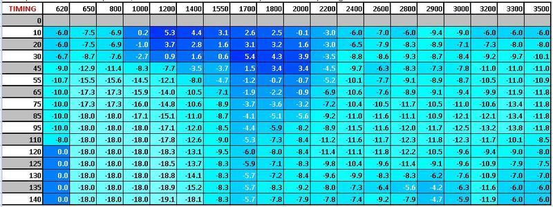

Yes the 04.5+ get a little lower mileage, mainly from the loss of injection timing to reduce the NOx production. A little off topic, but here it is anyhow. This is MY04.5 timing compared to MY03 timing. In general MY04.5 needs more timing for the same performance, based on piston design, than MY03 pistons. The cruise timing is a little higher on MY04.5 tuning, but the rest of it is much lower. Just food for thought, things like rail pressure also effect timing and duration, but the biggest different is right here. There are some claims that at 60 the MY04.5 tuning gets better economy, and that is possible but add any sort of load and the MY03 wins.
What are we talking about here a 1/2 MPG, 1 or 2 MPG, and what if any power is it really that detectable?
