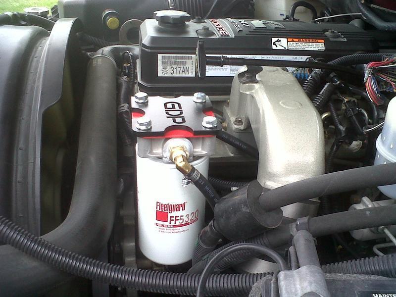

I received the GDP filter today in the mail and I also ordered the fuel tank vent kit. Both look like they're made very well. Can't wait to tackle the install on both of these.

I installed my '03-'07 Dodge Ram MK-2 + Big Line (Cylinder Head Mount) from GDP and wanted to give them the credit they deserve for fabricating a great system that went in way easier than I first thought. The system is well designed and the materials are very high quality. I ran it afterwards and not a single leak.
I would recommend their fuel filter systems to anyone!!
