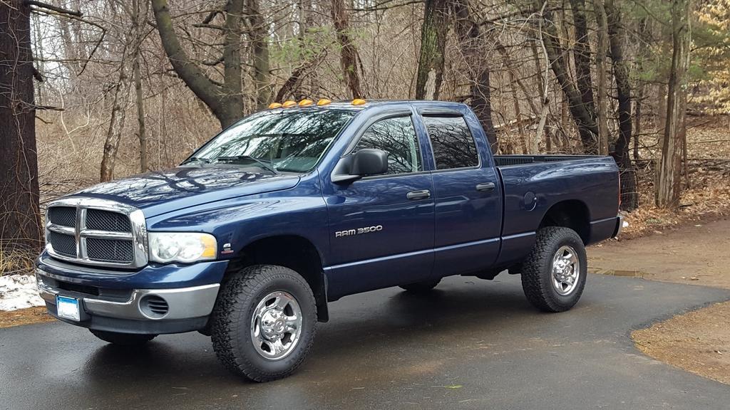

Hey all! I just picked up an 03 3500 Quad Cab SLT CTD... my first diesel. She's really clean considering her age and the 144,000 on the odometer, but does have a few quirks. Most notably is that dreaded "Lamp Out" I've been chasing, but that's not the reason for this post.
I'm wondering why this truck takes so long to warm up? I've been told that's something all CTD's do. It's been in the mid-30's to low-40's here for the past week. Even after having her plugged in overnight and warming up for 5-10 minutes in the driveway, she doesn't start to blow heat until I've driven for a few minutes. While that's not a huge problem this time of year, I'm wondering what it will be like next winter when the colder weather returns.
Do the CTD's really take a long time to come up to temp? Or is there something else I should be looking at like thermostat, etc?

Nice ride! :D
Thermostat comes to mind,might be good to change out as it could be old and it is a cheap fix.
There is a LOT of cold cast iron that needs warm up...
They take for ever to warm up with no load, if your e-brake is in good order put the truck in gear, it'll warm up in about 5-10 min.
best thing to do is, start, get oil pressure then drive. these are commercial engines designed for exactly that. start n go.

As mentioned- lots of heavy cast iron to warm up- and a lot of coolant too. In summer, you won't believe how cool they run, no matter how hard you push!
Might be a good idea to get Geno's winterfront cover for the rad. It works great!
1.Are you using a high idle?
2.Is your block heater actually working?
I would bet that you likely need a heater core. I've replaced several in 3rd gens this winter due to scale buildup and lack of heat transfer until the engine is really hot. At temps like you are having and being plugged in, you should feel some heat.

FWIW, I'v had this truck since new and I get no real heat at all with it just plugged in. It takes 7~10 minutes of driving before I feel warmth coming out of the vents.

This week the temps here in southern Connecticut have only gone down to the low 40's so I haven't been plugging in the block heater. Instead I've gone out, started the truck, set the emergency brake, put it in drive, and let it run for around 5 minutes before taking off. Heat starts after about 3 miles of driving. I guess I'll just have to get used to it and come up with an alternate plan for when winter returns (like a 12v heater perhaps).
