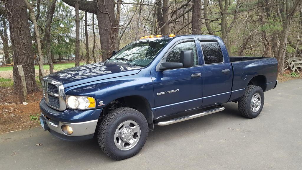

Now you NEED fog lights, tow mirrors, running boards, Smarty tuning, exhaust,..... ;)
New headlights, fog lights, tow mirrors, and nerf bars. She's starting to shape up.
