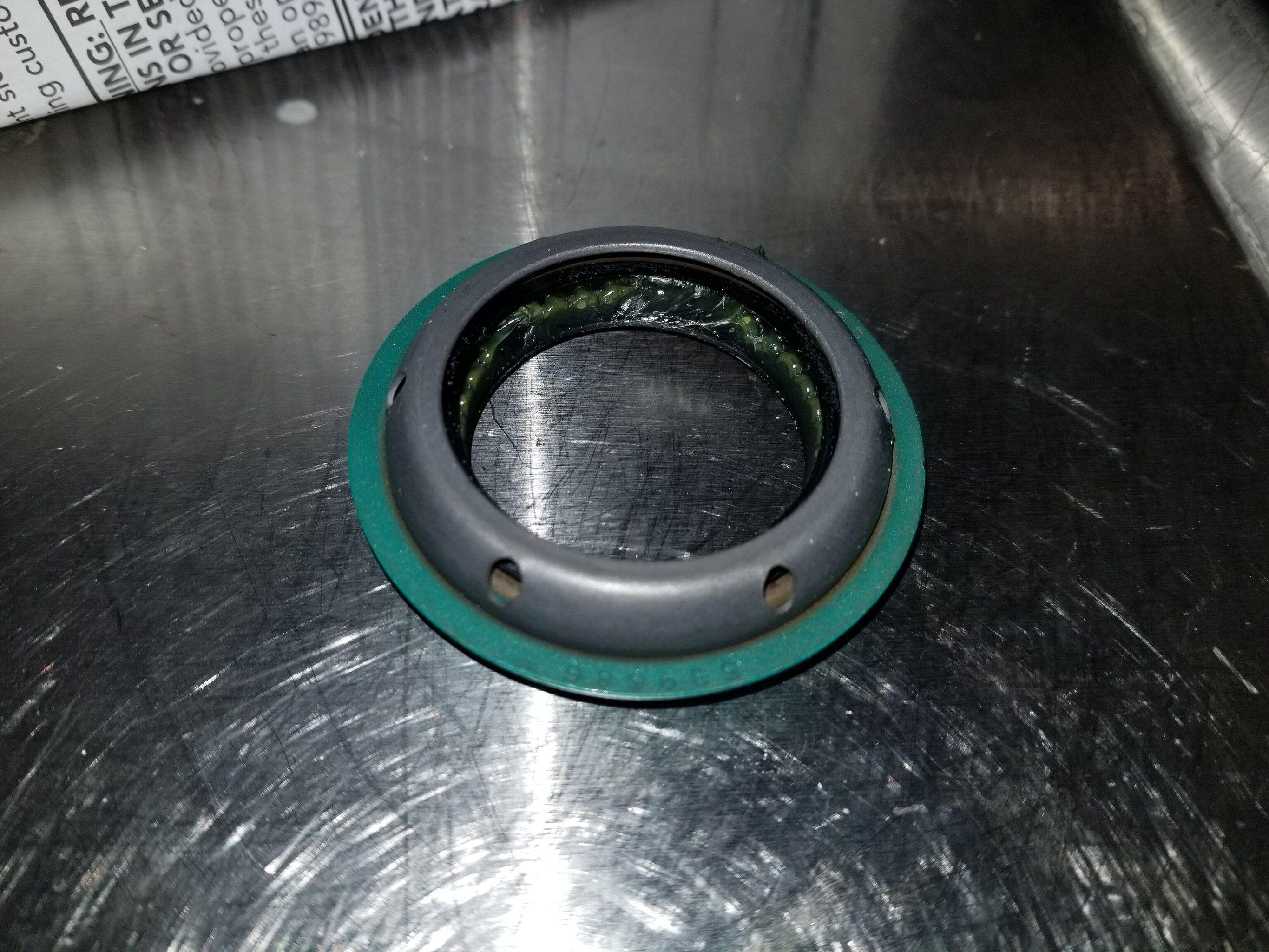

Old seal popped right out no issue, got my all in one seal driver kit, had a pretty good plan of attack, went to install and install and could never get the thing straight enough, rework my plan use some more parts and pieces from a second all in one seal installer kit still no luck. Now this is a normal oil seal except it has a metal gaurd around it to prevent rocks or stuff from damaging the seal. I would up bending the metal guard to the point I knew it would be an issue later.

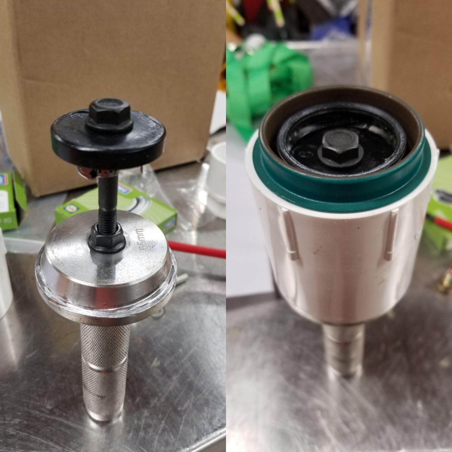

Went to tractor supply with my caliper in hand grabbed some plastic pipe odds and ends to make my own installer, then stopped by the autoparts store and found a exhaust adapter that was perfect looking. Well the plastic stuff never quite worked as well as it looked it was perfect, I modified my curent seal installer to make a centering ring and the sort but still could not get the right pressure in the proper location.
Moved on to the exhaust adapter, that was the perfect size, except was too thin and I destroyed the seal in 2 hits.

This was my home made set up, the issue is all you are hitting is the edge of the seal due to the guard. Looks cool did not work.
Guarded Seal

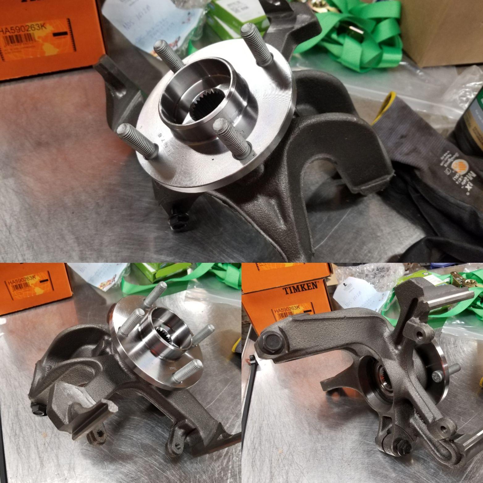

Pressed in the hubs and knuckles, at least those went in pretty nice, as its all new stuff.

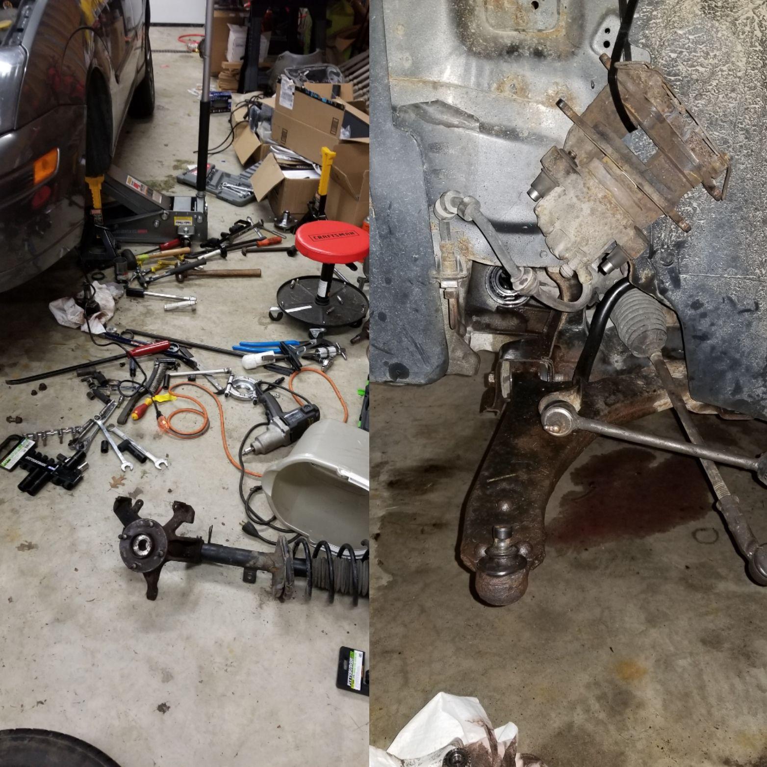

What a mess!
