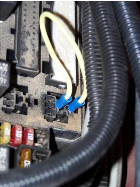

I purchased the headlight conversion harness from firefighter_2000 and it worked perfectly. You need to read his article and make your own decision. I have a 1999 and tossed the existing Britebox for the relay removal and jumped pin 3-5.

I would advise not getting a Sport headlight conversion without fuses.
