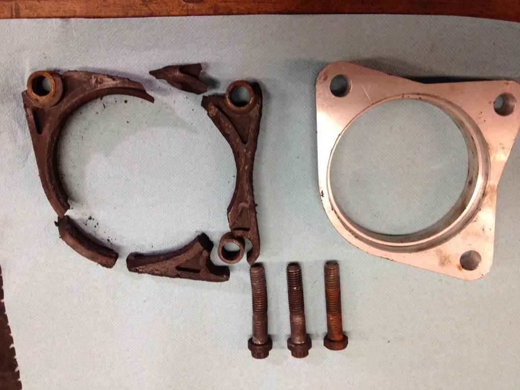

Jump in, turned the key, engine started to turn over and heard the most god awful sound for a second followed by whirrrrrrrrrrrrrr.
Still in denial that it didn't start, I released the key and turned it again. Whirrrrrrrrrrrrrrrr
What the ......?????
Popped the hood and looked down into the bowels where the starter resides....to find it missing!! Just a big hole.
Wait a minute....what is going whirrrrrrrr? Battery cable is being pulled so I look UNDER the truck to find the starter hanging from the cable, and just touching the bell housing so that it has a circuit.

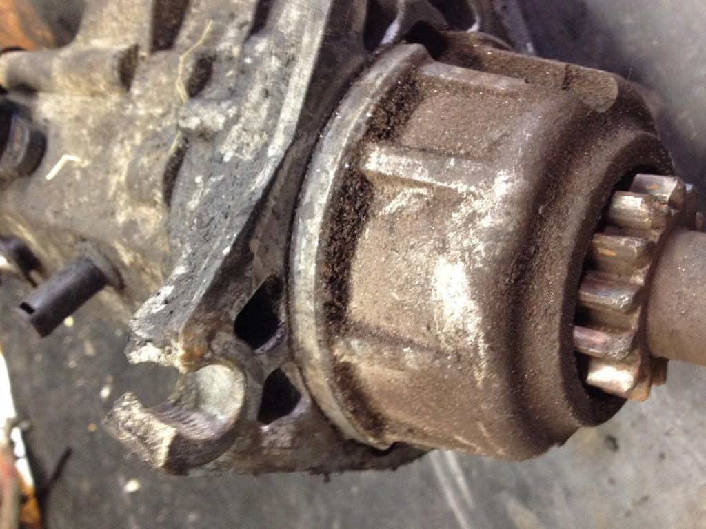

Pulled the starter off the cable and discovered a damaged ear. I was able to find two bolts (one bent) under the truck along with the remains of the spacer.
One new starter, spacer (solid aluminum this time) and 3 bolts....and a 3 hour delay....later and it was all back together.
Has anyone else had anything like this happen? I am finding it rather weird.

You think that bent bolt is saying something??
Up until this event...there was no hint of anything askew. Oil change was only 1500 miles ago and I look everything over while I'm under there. So either it hadn't started, wasn't obvious or my head wasn't in the game at that time. (an out of mind experience?)
Maybe put a barring tool in the other side, turn the engine over slowly and inspect all of the ring gear teeth looking for ugly stuff.
Did and done... nothing found.
Well, technically I found a flywheel and ring gear all intact and happy. :-laf
Other than the destroyed spacer and the broken ear on the starter, which I have cleaned up and repaired to use as a spare, there was no other damage found.
These starters have a tremendous amount of torque so it is very plausible the bolts came loose over time and allowed the starter to put a bind on the bolts and mounting flange until something gave way.
