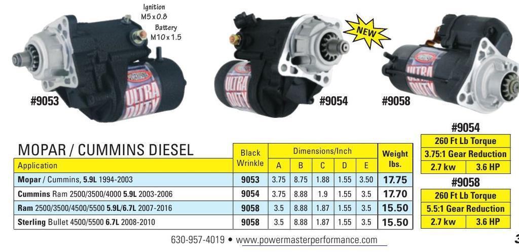

Powermaster starters 245 from summit racing brand new,just installed one on my 03,starts quicker,spins over faster than oem.
I've used Powermaster starters in the past with excellent results. They appeared to be based on the Denso design. I spoke with them before purchasing and at the time they were built in the Chicago area. Here's a snapshot from their catalog:
