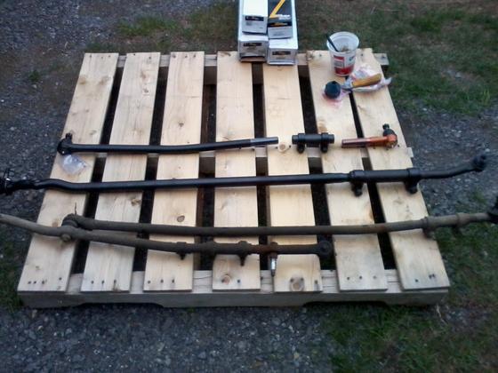

Hello,

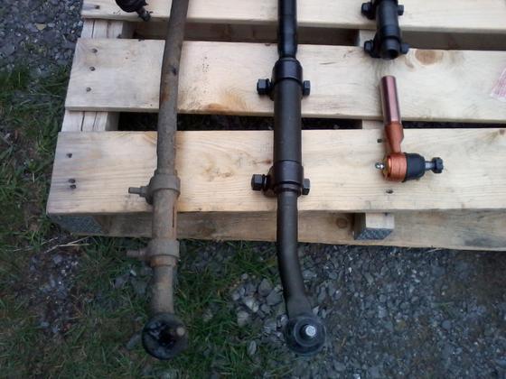

If your tie rods and drag link are shot, you could upgrade with the HD steering kit that was sold for 98 and 99 models.
I recently upgraded, the installation is a direct bolt on and the components seems very much stronger than the light duty parts. I know this has been discussed a lot of times, but it seems that all the people who have done the upgrade are very happy with it.

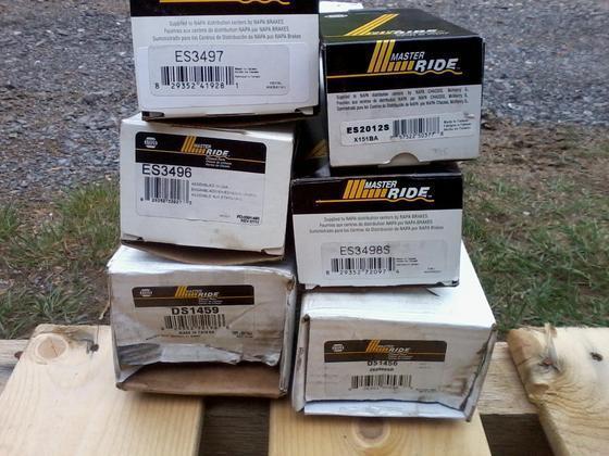

I've bought the parts from NAPA. The guy said me that they don't have Moog parts anymore because of too much return, but they have an other brand (do not remember the name... ) that is coming with a life warranty, and Master Ride,their economic brand. I choose the cheap one (because it's a lot of money !) and when I opened a box, I could read "Moog prob solver" written on a tie rod...
The only drawback seems to be that you can no longer use the steering damper, but my first test ride indicates that the steering is much more stronger now even without the damper.
