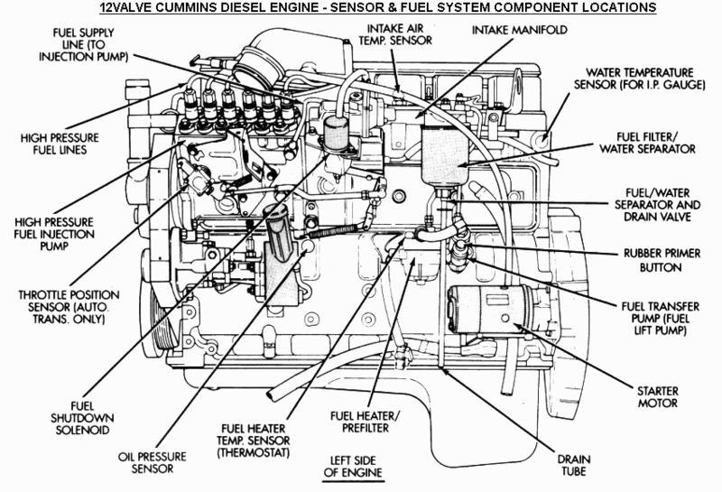

On the left lower side of the block. On a '95 probably near the power steering pump. You can hook a gauge to the fitting on the oil filter housing to do a quick check.

I noticed that there is a cover (cardboard of some sort) on the left side of the engine that is behind the injector pump
that is cracked & a little warped and away from the engine. Is this just an insulation panel and should I be concerned?
Mine was broken nearly in half and it's no wonder it didn't work.
The new one solved the problem and I've got good constant oil pressure
