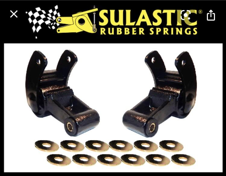

In my adventures perusing the Internet looking up topics related to my 2020 3500 I came across these.
https://www.sulastic.com/Big Horn 4dr Crew Cab LB (6.4L 8cyl 8A)-1
Looks like they replace your rear shackle and soak up most of the minor bumps to improve the ride of our leaf sprung trucks. I’d be up for a better ride. Less vibrations to the body will no doubt make things last longer.
Anyone see them or use them before?
They have been around for a long time , I know probably 15 people that have used them with mixed results. About half the people noticed a better ride while the other half did not but I have not heard of any issues with them.

Had them on my 06. They helped some with road vibration. Not sure I would do them again.

My 06 was a 3500 SRW. With the camper on, the Torqlift Stable loads (the ones that extend the bumps stops for the upper spring pack) were putting a lot of load on the upper spring pack. The loaded vs unloaded didn't change significantly with the Sulastic. I'm familiar with Saskatachewan roads as I've gone fishing up a Missinipe with a friend of mine from Regina a few times. I think the shackles probably gave the best improvement on the logging road between La Ronge and Missinipe as that is mostly dirt road.

The Shackles finally arrived and I installed them. It took ~3 hours. Truck is noticeably smoother. Washboard doesn’t bounce the truck around. Better eat your wheaties before your install, cracking bolts takes some effort.
What part number kit did you install?
