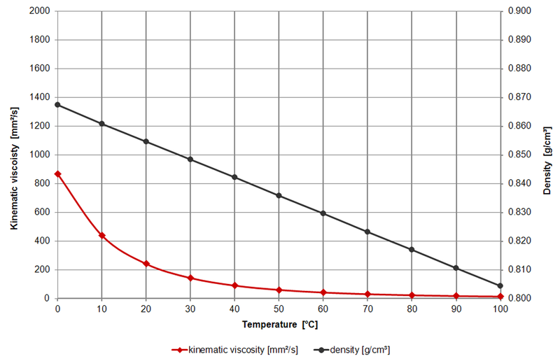

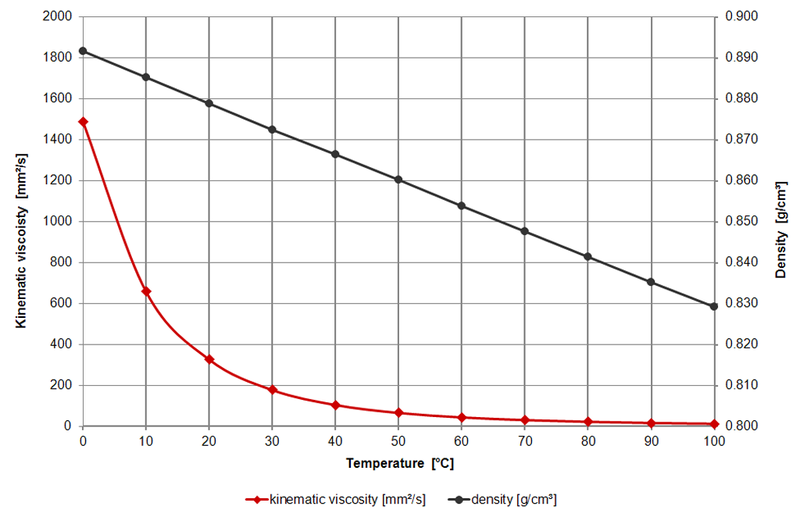

yeah, this is the viscosity charts for 5-40 on top and 15w 40 on the bottom.... by 20C 68F the difference is small enough not to make much difference. .. my personal opinion is Mopar should have just specced using a synthetic 5w40 for everybody based more on the idea that 5w40 are all synthetic and composed of higher quality base stocks than conventional oils.. because the difference between 15w40's and 5w40 is negligible or non existent at normal operating temps..

Have you looked at the specs? There is a difference at 40°C (104°F) that only gets more distinct as the oil temperature drops.
biggest diifference in the 2 is below 20C.. above that temp the differences start to amount to a rounding error..
but I digress, my main thought it why do they think you can't use 15w40 in a hot climate? the deposit thing should not have any difference when it comes to viscosity as that is more of the subject of additives and add packs are vastly similar across any brand from bargain basement to fools gold.. Other thought is the matter is also how long does one of the engines operate at low temps compared to normal operating temp? Because the viscosity thing sounds more like hyperbole than an actual thing, unless these engines suddenly became delicate because of hydraulic roller lifters and a CGI block.
A rounding error? Just looking at one series of oil the 15w-40 is 19% thicker at 40°C than 5w-40.
