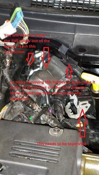

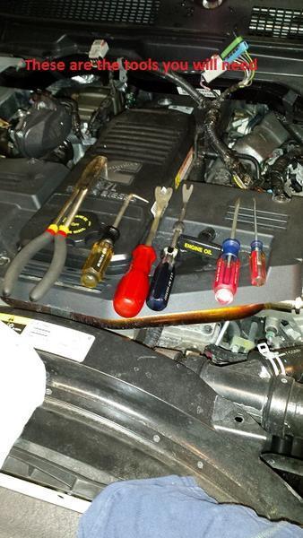

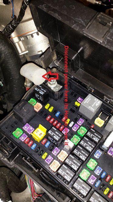

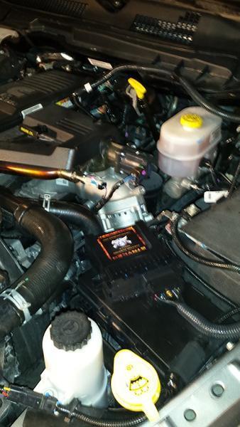

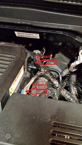

The Bank connections will require a Harness puller or Huge lock jaws. My spelling like usual Is bad If You have Question(s) call If I can answer them I will otherwise call TS, Tech support is good.
It is all Plug and play, takes Maybe 30 Minutes to install and remove in as little as 3 seconds (Ripping it out) or 15 minutes to remove by disconnecting.
