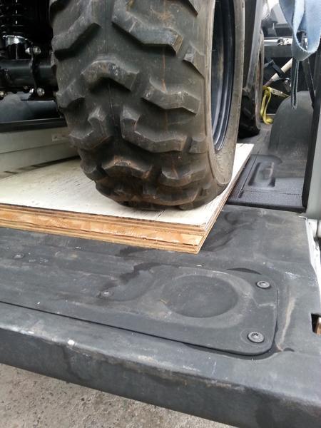

diesel4life refer to the specs below. With my racks front and rear, extra fuel can and saddle bags it's getting close to 675 lbs and maybe 700 lbs.

Yesterday I did exactly what you mentioned and pulled out 2 smaller sheets of 3/4 inch plywood that I will lay down on the tailgate. That way when I park the quad on it for the trip it'll distribute the load more evenly and some of it to the bed of the truck.
FYI - Yesterday I noticed that from the past trip I did with the quad there are two slight low spots on the tailgate where the tires road for 22+ hours. Glad I caught it before they became too big.
