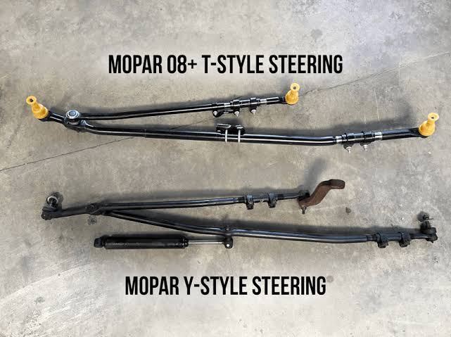

Did you do the T-steering conversion already?

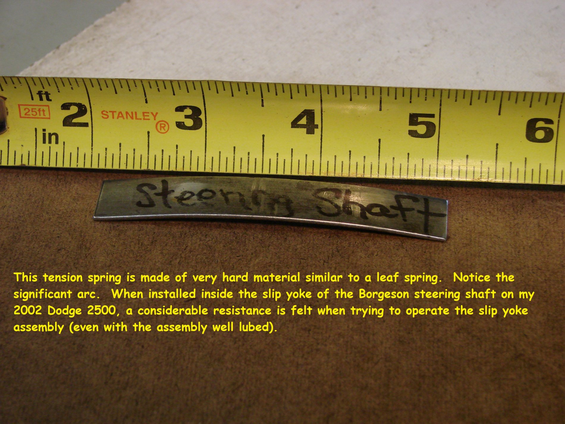

In my opinion, this steering shaft is not an upgrade. In fact, on my truck it caused steering problems similar to yours that took me over 25,000 miles of driving to figure it out. The problem was in the design of the telescopic part of the steering shaft (sometimes called the slip joint). The tension from the style of spring used in the slip joint caused so much friction that it didn't allow for axial movement of the two halves of the steering shaft.
The photo below shows the tension spring used in the slip yoke. I even used a press to reduce the arc of the spring. It made no difference. I removed the spring and reassembled the shafts. Much better performance; however, after driving with that shaft for over 170,000 miles, I replaced it with a Dorman steering shaft (built like the OEM shaft). Here is what I wrote in my maintenance records at the time of replacement:
"Replaced Borgeson steering shaft (still operational). This shaft is poorly designed with 10 set screw / jam nuts to hold parts together, which makes it a high maintenance item. Set screws are difficult to inspect or to tighten after the installation of steering shaft. The slip joint offers too much friction and has to be disassembled to grease. After driving a few thousand miles, the slip joint gets sticky and affects steering performance and needs to be cleaned and re-greased - not a simple task. I also feel that set screw type clamping pulls the clamped components off-center, which is felt in the steering wheel.
The Dorman replacement steering shaft appears to be of very good quality. Only two OEM style clamps for installation (keeps components centered) which makes for very easy installation / removal and is virtually maintenance free. The rag type joint removes vibrations transmitted from the road. This shaft is quiet and very smooth - far better than the Borgeson steering shaft."
I have since logged 18,000 miles on the Dorman steering shaft and it is still smooth and quiet. I spent $270 on the Borgeson shaft and $127 on the Dorman shaft. Sometimes I learn the hard way.

Never dug into the steering stuff, looking at the picture Ozy posted what is the largest performance difference between the T and Y.
The top one does not show a stabilizer, does it use one?
I can see the tweaks in the connection points and angle adjustments, they are not drastically different, but they are not the same either.
I can't explain it very well but there are articles out there about it. Before I did mine, I read several articles but can't remember much now. I did have to use the '12 ram damper. The '01 won't work.
Some info here when I did mine.
https://www.turbodieselregister.com...tenance-on-the-01.259915/page-16#post-2687017
https://www.turbodieselregister.com...tenance-on-the-01.259915/page-17#post-2687096
I installed the Delron bushing I believe you reference and it was a nice improvement. My truck has over 360k miles, and before I bought it (@ 275k or so) it had 35" tires and also had a snow plow on it, so all kinds of things were worn out. I went to the t-style and much prefer it, especiallyfor setting the toe; those who need off-road articulation may not.
