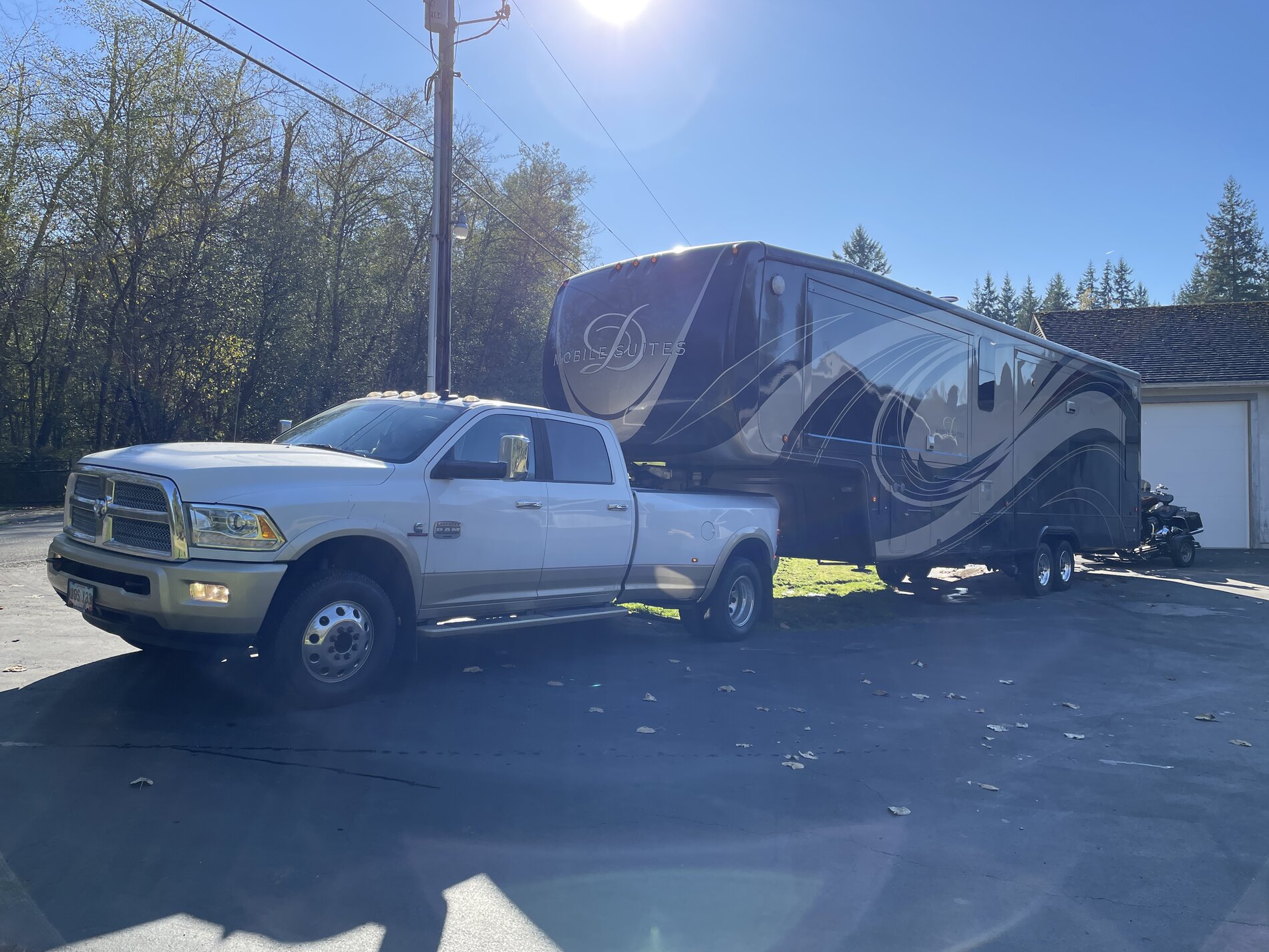

Truth is not many folks really need a diesel pickup. Those that do and pull big 5 th wheeler trailers etc would be much better with a semi truck good used etc. I certainly never really needed a diesel but I did need a 1 ton truck to haul my load .But once the diesel monster bites it’s hard to go back. I did really consider buying a 1 ton gasser this time but my love of the Cummins won over again. But I must admit the power train transmission exhaust brake set up the whole power train is pretty awesome. Oh and no exhaust brake on a gasser,once you have one it’s hard to go back

Today I will be traveling SB I-5 Oregon into California with many miles of 6% downhill at over 35k combined. It’s so nice to select your gear and cruise control speed and without touching the brakes safely do it over again snd again. Notice the MC trailer behind the 5er.

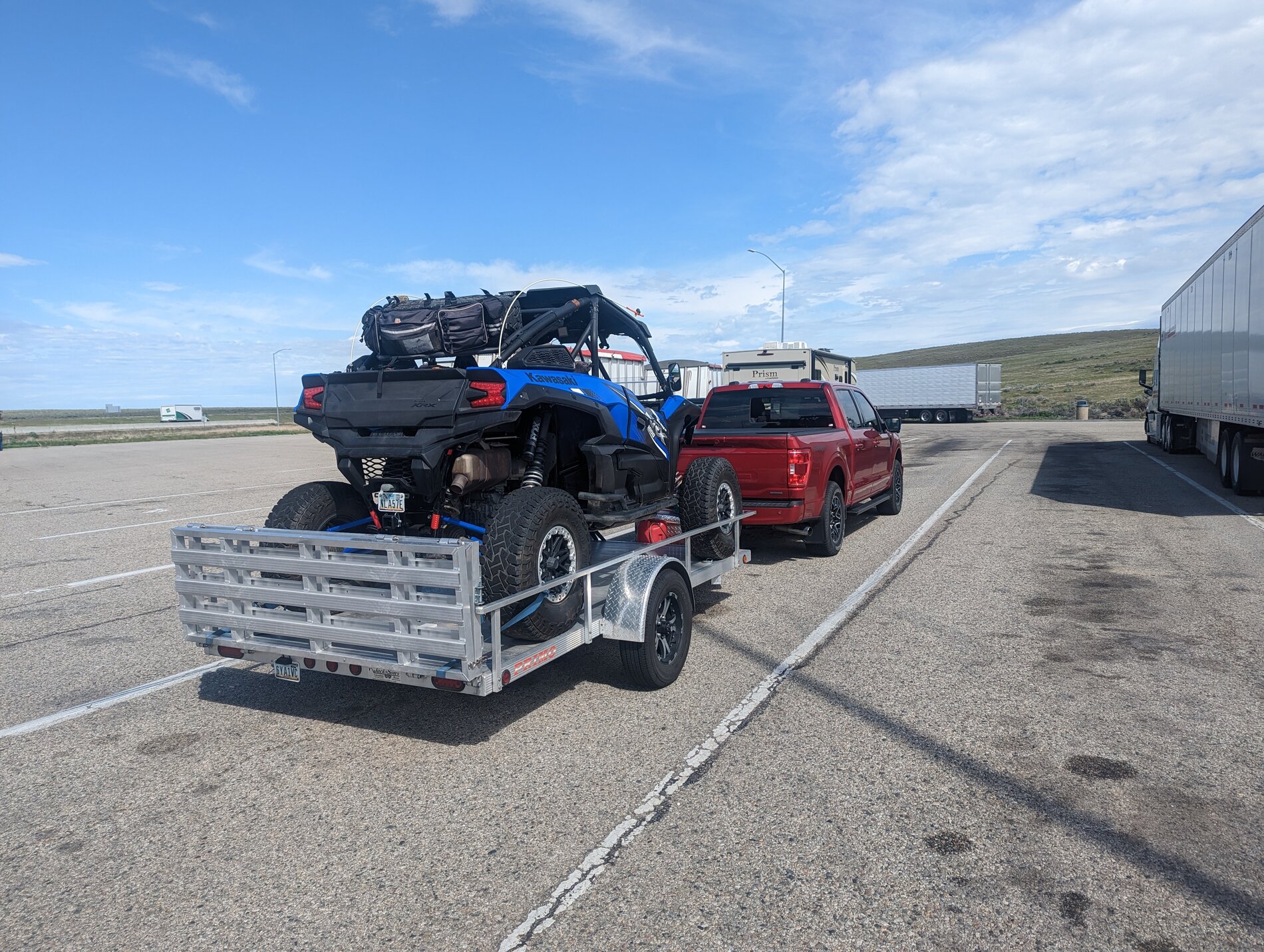

Most modern gas pickups today have a tow/haul mode that keeps the torque converter locked. I use that while towing a moderate load of 3300 lbs. I will go down as low as 2nd or 3rd gear(out of 10 available) on Western States passes, and can descend these will little use of service brakes. My F-150 is rated to tow 6600 lbs, and at that weight the tow/haul descend feature will be greatly over powered by that much weight. I manually choose the gear I want to maintain the conservative speed that "I" want go down the grades.
