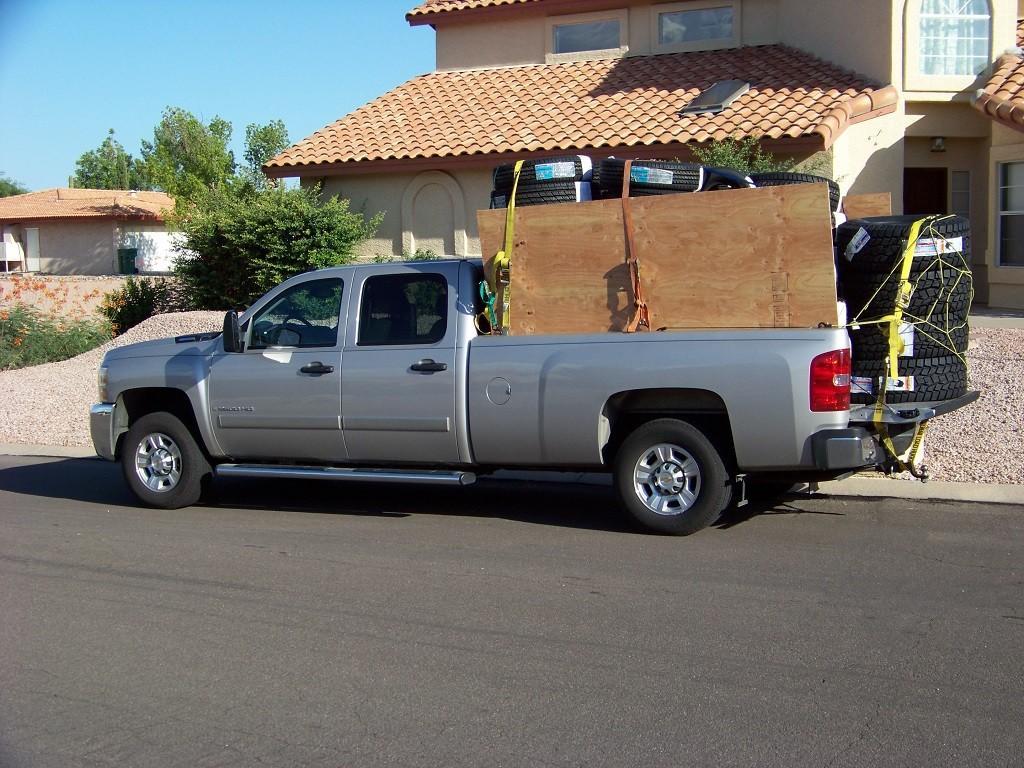

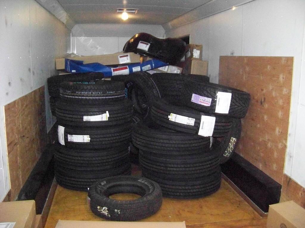

FED EX lady HATES me.
:rolleyes: Tires roll off the truck or trailer. It's loading them that's not fun.
