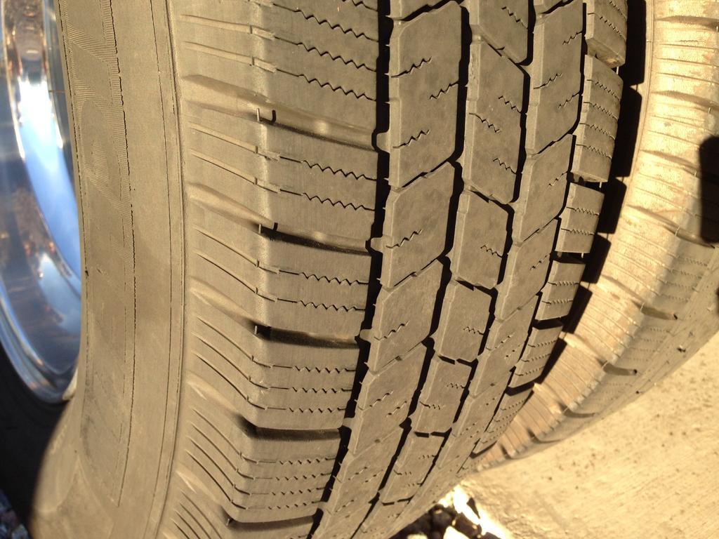

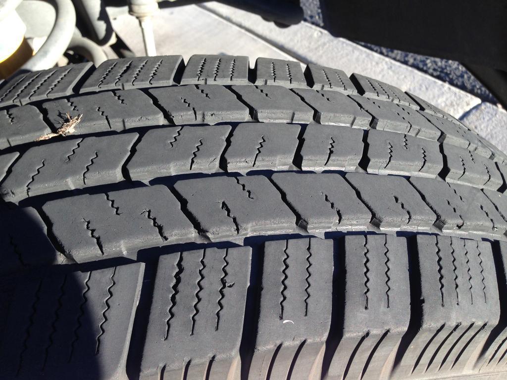

Here is a couple pics of MS2's with 40K on them running 80psi front always and 45 rear solo and 60 loaded with 5K pin. The tires were 1/32 thinner in the middle at those pressures so I am running 40 on the rear of my 15 now.
I wish I would have taken pictures before my first tire rotation......
I had to experiment over many months to find the right pressures for my truck since new (October 14). I had been running between 65-70 in the rear. When it came time to rotate them, it was obvious that the center tread had worn more and the tread on the sides had little to no wear. Each lug on my tires (Toyo Open Country AT II's) has (had) a small step down of maybe 1/8 of an inch (going off memory here). The step was long gone on the center treat, but it was all there on the edges, and if I looked closely, I could see that the tread on the edges was not even contacting the ground. Nobody intends tires to be used that way, not the auto manufacturer, nor the tire manufacture.
View attachment 92148View attachment 92149
