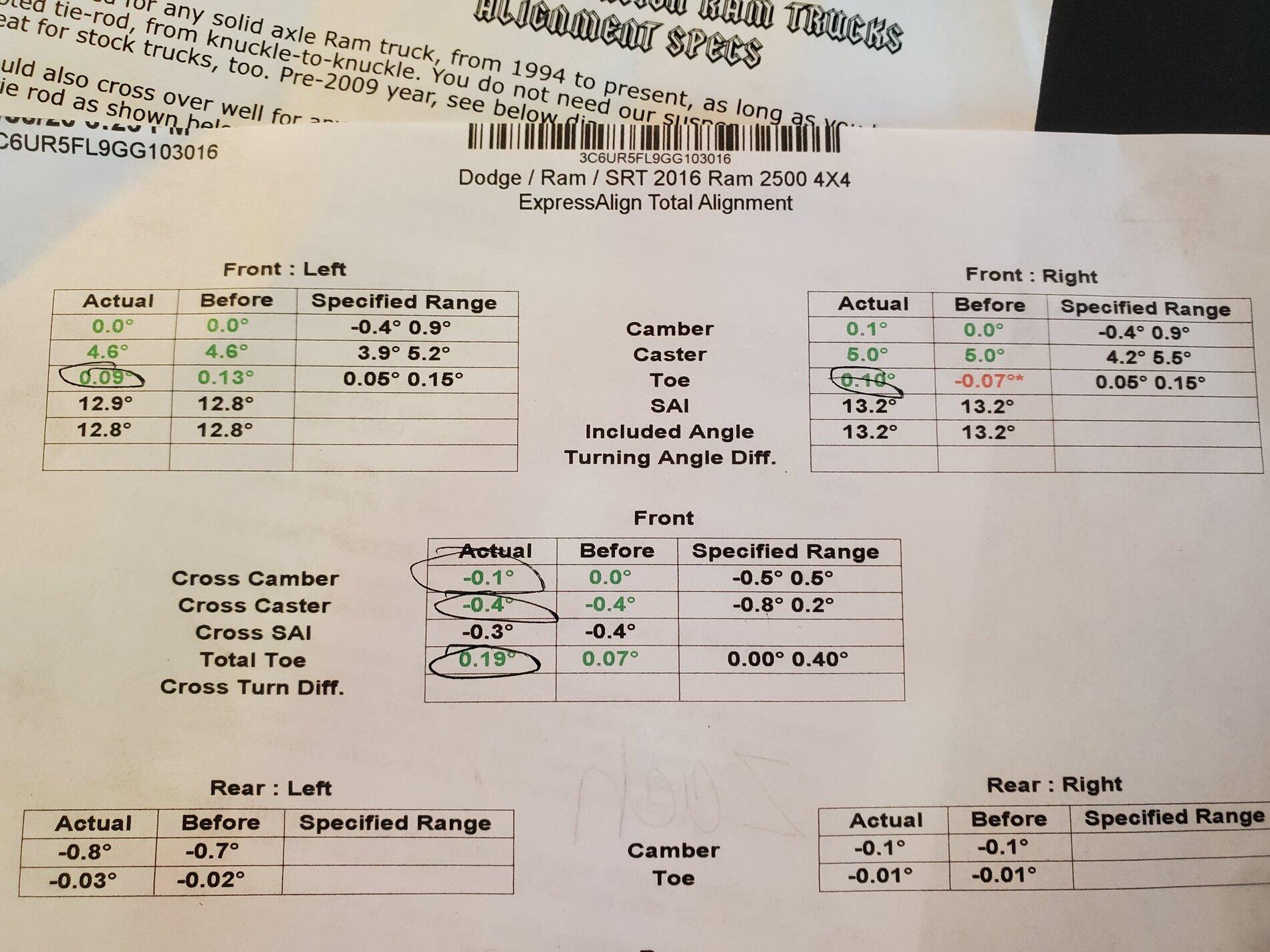

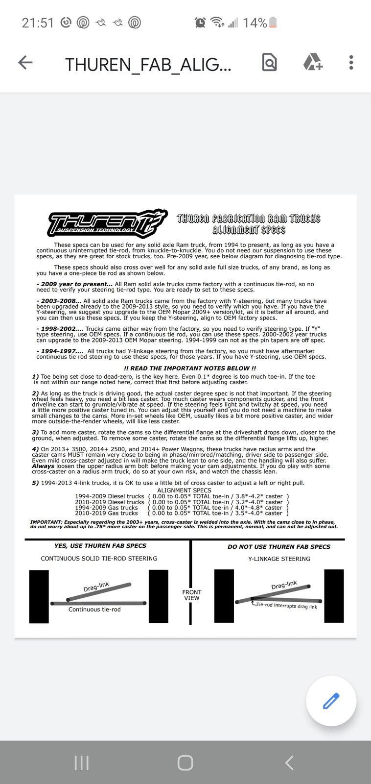

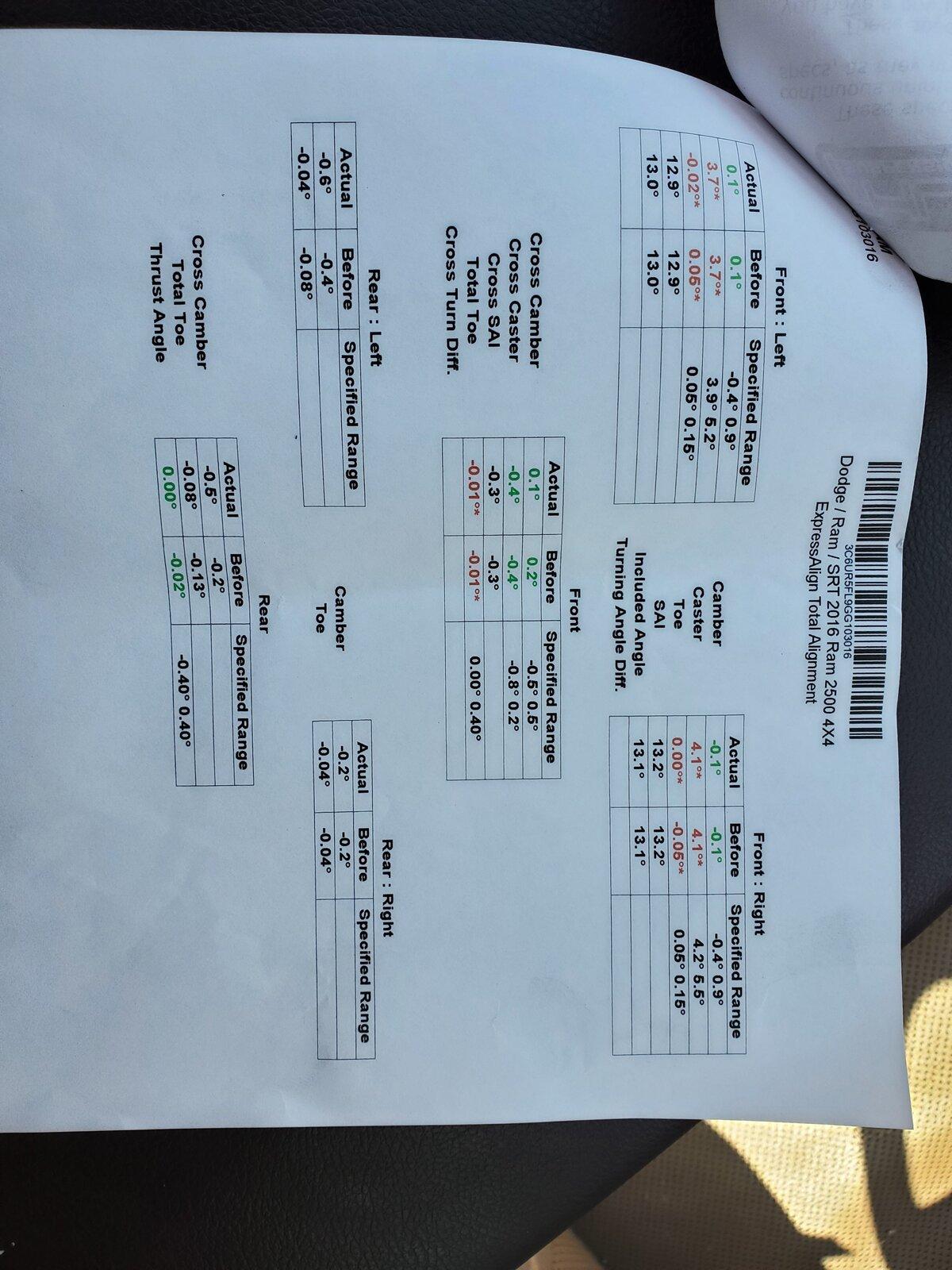

I just picked up my truck from tires plus. They installed 295/65R20 Toyo AT3 on my 16 ram 2500. I provided them the Thuren alignment specs. This is what I was given back. I am returning tomorrow to have their master tech give it a go.
Thuren specs for my truck is the second line.

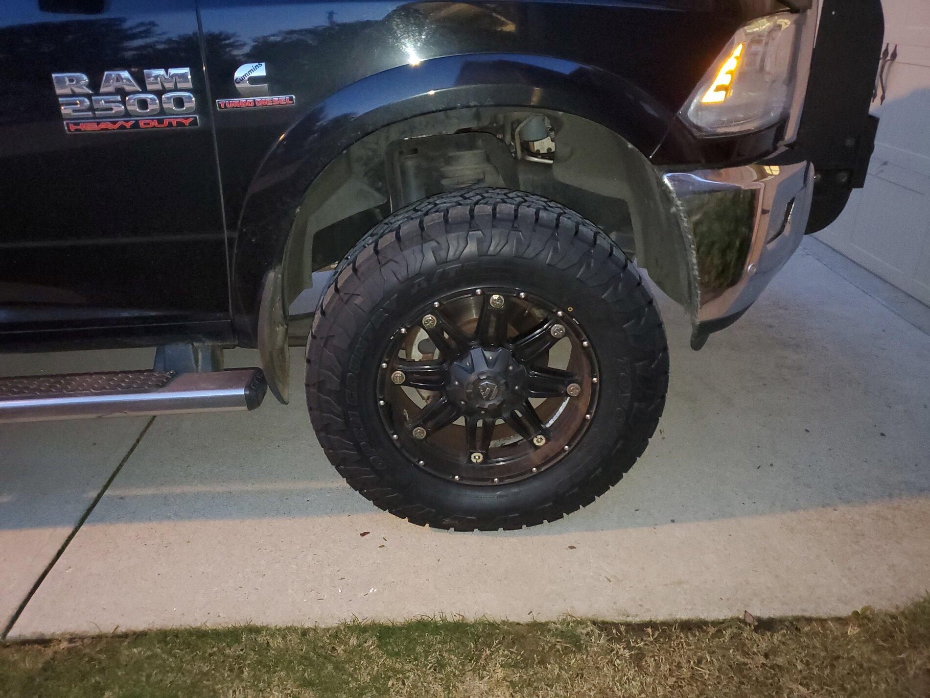

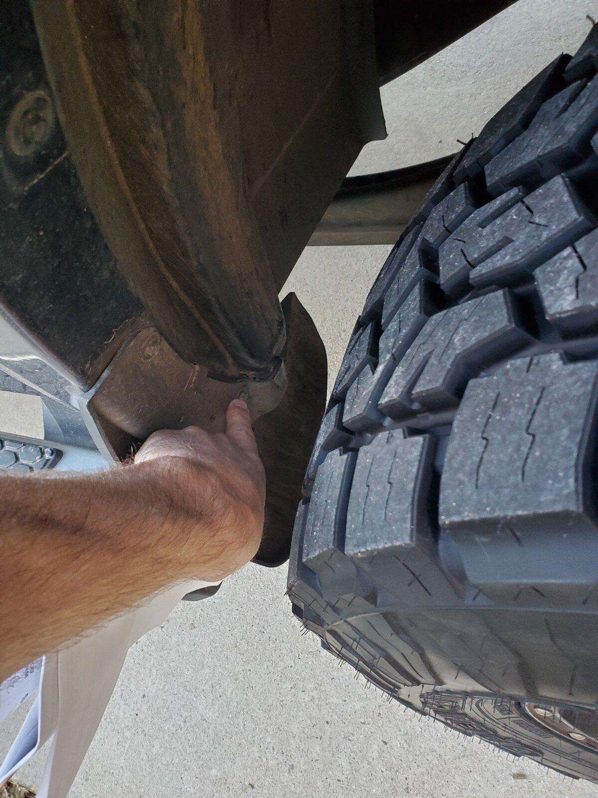

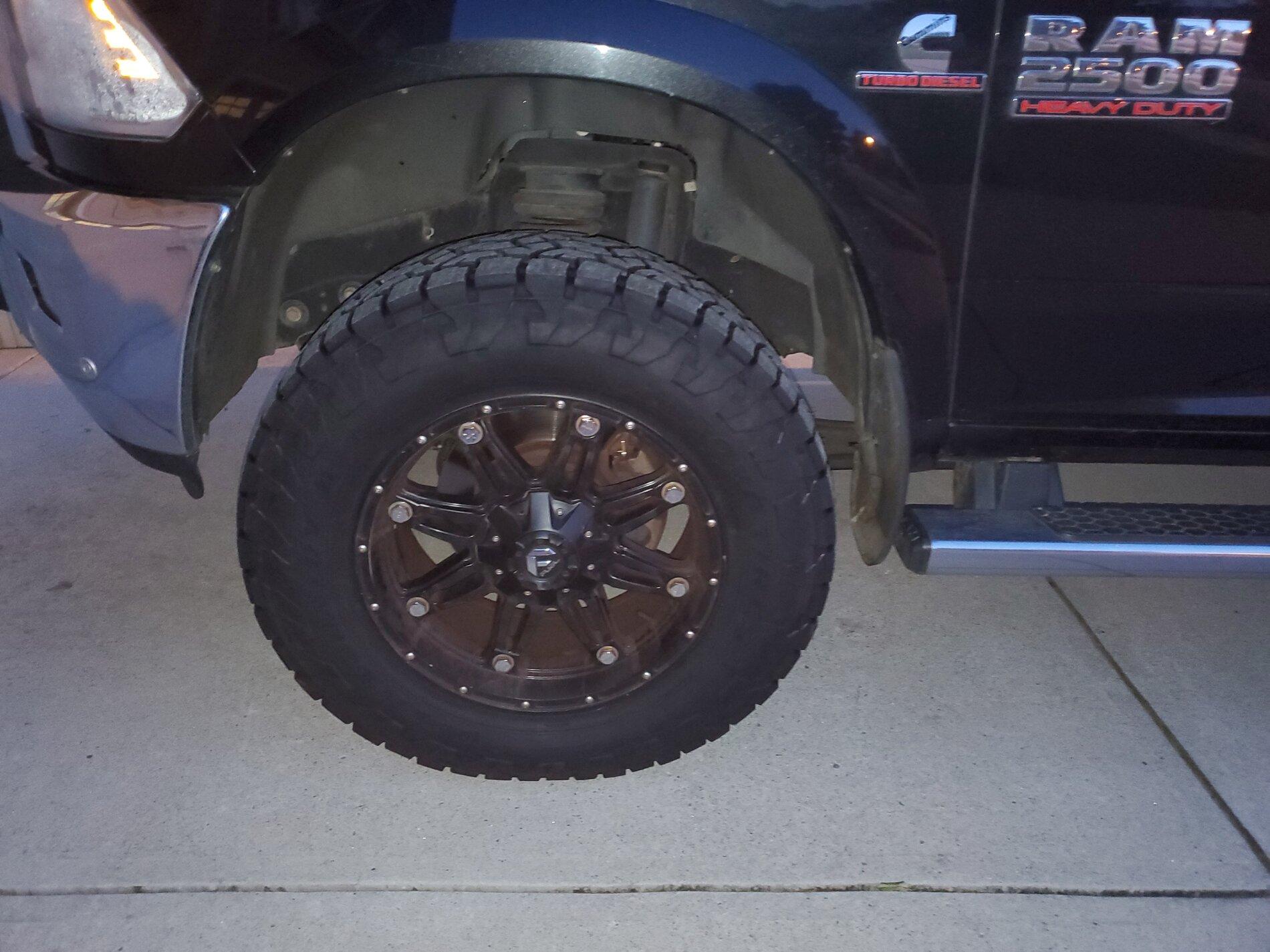

Lasty i noticed a bit of rub on the rear portion of my front fender at this point (see third pic) the truck has a puck leveling kit on the front and I don't plan on changing that. Is it as simple as trimming back this plastic?
I went from a 275/65r20 to 295/65r20.
Not that big of a jump. Surprised to have any rubbing
I'm unsure of the wheel width or offset.
Offset and width possibilities are
20x9. 1 or 20
20x10. -12, -18, -24
